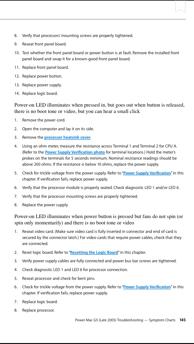

There are 7 LEDs on the front of the logic board that can give you a lot of information as to the faults happening when you power it on. The service manual will give you a fair bit of information about what faults the various light/light combinations mean.
BTW, in my experience bad RAM will give you 3 beeps along with three flashes of the Power LED.
If the computer doesn't chime, either the speaker is bad or it hasn't successfully completed the POST. The failure to POST is-I would say-most likely. Again, the LEDs on the logic board can give you an indication of where in the POST it's hanging/failing.
Ok so from what the seller has put in the description and from what I've found in the service manual, I've narrowed it down to these last 2 issues
so it could be a few things, I'm hoping it's simple and I don't have to pay a ton of money for a new logic board, processor or PSU. Just curious, how much did you pay for your processor?
I can tell you from experience that when you're doing diagnostic work, don't skip any of the processor screws. Some of them are responsible for providing power-in particular the four rearmost ones that screw directly into the cards. Leaving one of these screws out will cause a hang.
If the processor/LCS module hasn't been removed, check in particular for one or both of the processor LEDs along the front illuminating during POST. If either/both of these light, it may have LCS damage(although leaky quad LCSs are unusual). If either of these comes on, I'd run unless you can get it REALLY cheap.
