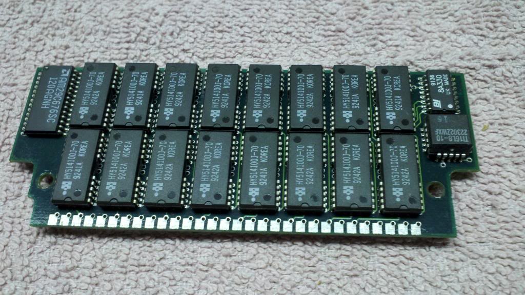

On a side note, have you ever seen ram like this before?
Yup. Looks like bank switching RAM. Huge stuff for 32pin RAM, but necessary way back when.
What do you mean by bank switching RAM? And when I have one or two of them plugged in, so it is in a series of 2 other sticks of regular,4 in total, why would it give me a SIMM error (death chime)?
It's possible that one of them is faulty, or the Quadra 950 doesn't like this kind of RAM. The square looking IC is what tells me there may be some bank switching going on. All I can tell you is that is how our memory supplier described them years ago. I never understood nor researched what it meant but suffice to say there is additional logic on the SIMM which some machines don't like.
The real issue is that the Quadra 950 needs -- wait for it -- 4 SIMMs at a time when upgrading RAM. That is, the total number of memory SIMMs fitted MUST be divisible by 4. 😱
Total possible memory is 256MB made up of 16 16MB SIMMs. 😱
I knew that it needed four, but I didn't know the size of the RAM...
