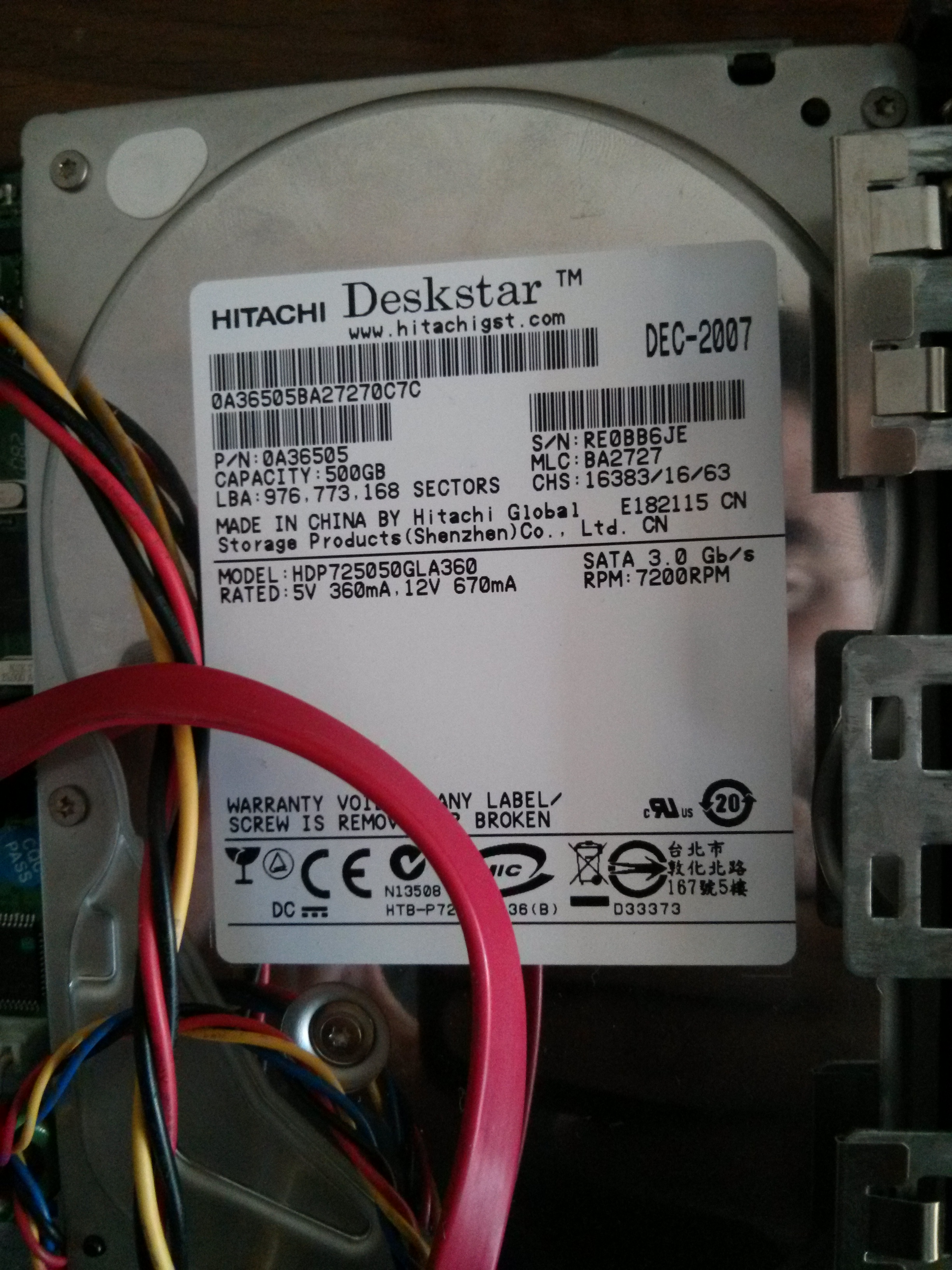

Hi guys, a friend just offered me a Lacie Quadra D2 (Firewire 800,400, esata and usb2.0), we wants it HDD back so I need to put there a new one.
The HDD that comes with it is this Hitachi Deskstar:
I tried to replace it with my Samsung HD502J 500Gb and the disk doesn't start spinning.
Tried an old Western 160Gb and the same.Both HDDs go fine in another enclosure.
The Lacie works fine with the Hitachi.
One thing that I noticed:
Hitachi:
12V - 670mA
5v 360mA
Samsung:
12V - 500mA
5V - 700mA
Do I need to find an HDD with the same amperage @5v of the Hitachi?
I can't seem to find one...
And the strange thing is that lots of people said that for example Western green drives are ok (and they are rated for: 5v:0.7A 12v:055A).
Any idea?
another thing, how do I update the firmware on this?
Tried all the tools available for win and mac and only one could say me I had firmware 1.02 and that I don't have updates (I guess this shouldn't be true, because there is an update of 2012 for it).
I can't see why those drives would not work. We didn't test these products with every possible hard drive available at the time, so matching as many of the specs of the original drive is the best way to head. It is possible some of the components didn't get re-connected quite right, were damaged during the swap or possibly a failing power supply.

Hi, thanks for replying =)
I already sent a ticket because of upgrading firmware on it (on Lacie website it says my Quadra V1 has updates but I can't install any).
About the hard drives,both the Hitachi and the samsung were tested in another enclosure and were fine.
I guess the lacie's power supply may be dying because even sometimes the Hitachi fails to work (may be a coincidence, but during some tests the hitachi only turned on if ater being formated).
