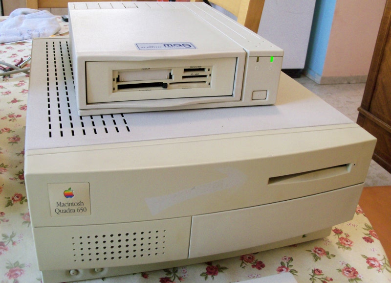

A long time ago, I bought a SCSI flash card reader with the aim of using it with my Emax sampler. It's been in the box ever since. Today I got it our of the box, put in in an external SCSI enclosure (that was harder than I thought it was going to be), and connected it to the Quadra 650:

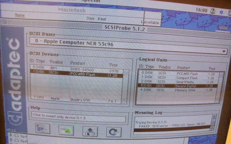

The results was interesting. SCSI Probe recognized it, showing all of its different logical units:
However it wouldn't mount an SD card (128MB from an old camera) saying "not a Macintosh volume". If I removed the card, it showed a different error, meaning that it definitely recognized the card.
It seems to me that it I could format the card, it would work. What software could I use to format it? My Mac Mini, BTW, can read the card. It says it's formatted as Fat16.

I am coming to the conclusion that it is not possible to format an SD card while it is in LUN 3. No software seems to support this option.
The solution is to use a PCMCIA to SD adapter and put the card in LUN 0, or to format the card outside the Quadra.

I just had confirmation from SCSI Probe itself.. If you click on LUN 0 and then click mount it gives a bunch of errors and then says "multiple LUNs not supported"
Apparently LUN 0 does work though. I will need a PCMCIA card adapter to prove this.
It works - I was able to partition, format and mount a 2GB Compact Flash card in a PCMCIA adapter. I was even able to boot from it 🙂
I used FWB Hard Disk Toolkit; I couldn't get anything else to work.
