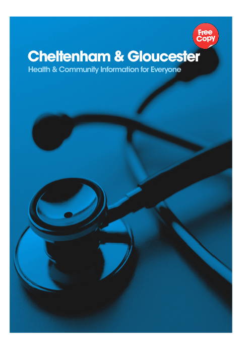

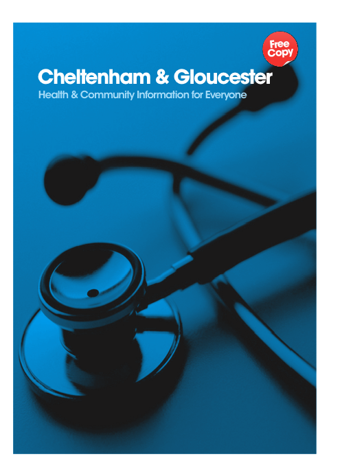

So from the attached you will see a screen shot of what I want to achieve. i.e. a front cover with an image, some type and a 'free copy' sticker in the top right corner.

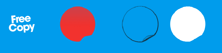

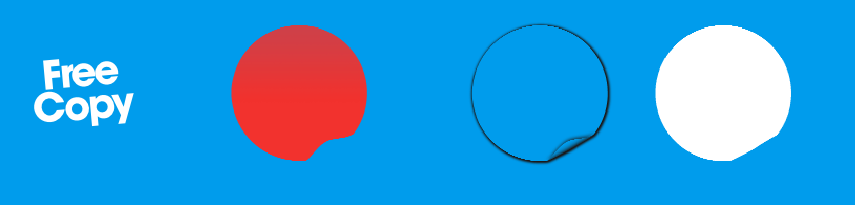

Because I am limited to 3 colours I have created the sticker using 3 elements. The black bits (shadows) the red bits and a white element all using greyscale tiffs. Then simply added some text over it to create the illusion of a sticker.

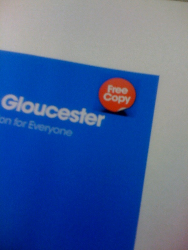

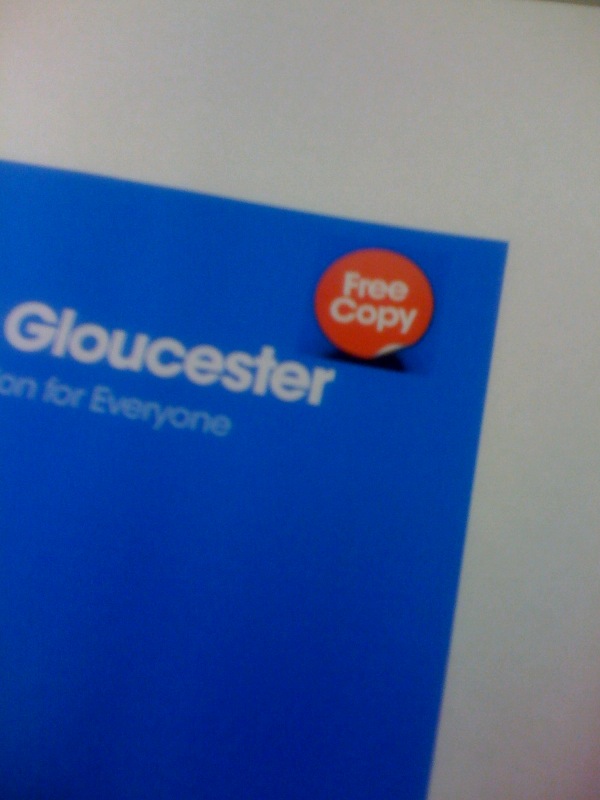

The problem comes when I try to proof the entire piece that as you can see from the photo taken from my phone that the main image disappears and that the sticker now has a weird outline which the background image seems to appear inside of.
If I move the sticker so it encroaches the Gloucester text the red part of the sticker turns black and I still have no main image.
I believe its down to the transparent aspect of some of the sticker elements but being greyscale tiffs why should it be any different to a bitmap tiff?
What the hell is going on?

And oh boy. It's a bit of a roundabout way to achieve what you want, layering and aligning all these greyscale TIFFs and colouring them up in luvverly Quark. I would have done the sticker element within Illustrator like a shot, there's no reason why an eps should have a white background to it and you can proof and check the separations and trapping for it before you even bring it into layout. It is the best way and to be honest, it would be far easier to walk you through your eps problems than this Quark construction.
What's more, using transparency effects within a spot colour job is not recommended. They behave in unpredictable ways and your proofer is trying to interpret these transparencies interacting with spot colours.
Anyway, with this sort of weird 😀 working, what you have to do is to not worry about transparency at first, it's two things: greyscale TIFFs have a solid background that needs checking, and trapping of the contents of the box, the box itself multiplied by three for each of your components.
Also, to make things easier, there's no reason why the white type and solid red need to be greyscale tiffs. In fact, if you're going to PDF before press, if you're not careful with your PDF output, the white type will be downsampled to 300ppi meaning lack of crispness. You can make the red solid, white background and the white type bitmappped TIFFs at 1200ppi, they'll stay sharp through your standard press PDF output settings whether through Distiller or Jaws engine within Quark.
For a complete transparency it's better to set the colour to 0% and then change the trapping for that element to overprint.
If I had to do the job like this, this is what I'd do:
1. Get everything else perfect, background image, title and strap. Make sure that title and strap are knocking out in the Trapping palette. Lock that layer.
2. Create a new layer. Make the white background a 1200ppi bitmap tiff. Introduce and position the lowest element of the sticker in the stacking order which is the white background. Colour the content white. Make sure the content of the box is set to knockout and the background set to overprint. Then run out separations on a laser printer straight from Quark. Check that everything is as it should be. Lock that layer.
4 etc. Import and place using the same routine for all the bitmap components. Check seps either by laser or by PDF at each stage.
I know I've missed something here while trying to walk this through in my head. I'm not in Quark at the mo and I can't be arsed to create standins for these components to test this out with.
But I would never have gone this route in the first place. The way to do this is by making an two spot colour eps of the sticker in Illustrator. I'm not sure why you're having problems getting a transparent background but if time was of the absolute urgency, I'd put a clipping path or even tweak the auto-clipping with Quark around the sticker to deal with the background using brute force. Problem solved.
