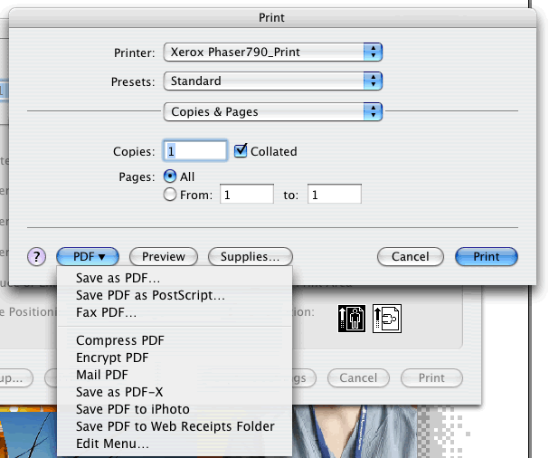

Just switched over to a new Dually, and with it, Tiger. Now in Quark, when I go to print a postscript file to use in distiller, the option to do this is gone. (The 'ouput options' choice in the drop-down list is no longer there.) There is now a 'save PDF as postscript file' option under the PDF button that I never used to use, but this doesn't appear to even function. Anybody know what I'm doing wrong? (Quark 6.0, 10.4.3)

Interesting though (and I assume this is just Tiger), look at this screen grab. The drop down is now the place to select the postscript option, while it used to be under 'Copies and Pages' as 'Output Options>postscript'. I hope it is still doing it the same way under the hood.
Hmmm. thinking about it, I used to be able to have ANY printer selected and make a postscript. Now I have to have Adobe PDF defined as my printer. Still confused. 😕

Turns out my issues are a combination of a couple things... one is that they indeed have moved the 'output options' option down under the Save as PDF button, and two, there is a glitch where it won't let me save off the postscript with this option unless I switch to a different printer and switch back to my preferred printer. Werrr. Either way, working now (with stupid glitch workaround)
