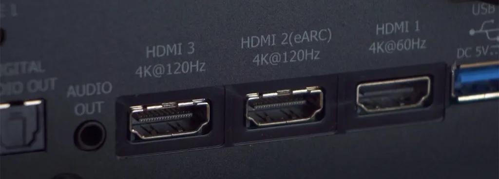

And if they currently lean on any apps in the TV (or the TV using over-the-air signals from an antenna or cable), this setup would interrupt flow of audio from TV to speakers in favor or injecting AppleTV. In other words, AppleTV would need to take over for whatever they watch in this splitter setup. If they want to keep using the TV as they do now, you need to preserve the connections of TV to speaker system and thus need AppleTV HDMI signal to be delivered to TV where it will display the video and pass through the audio (which is usually via eARC HDMI port). Look for the (eArc) reference on one of the TV ports as shown in port 2 in this example...
full
If "cinemaset" is not already connected to that port, you might switch it to the eARC port and then connect AppleTV to one of the other HDMI ports. If this is available with their equipment, you are probably set- no splitter required.
