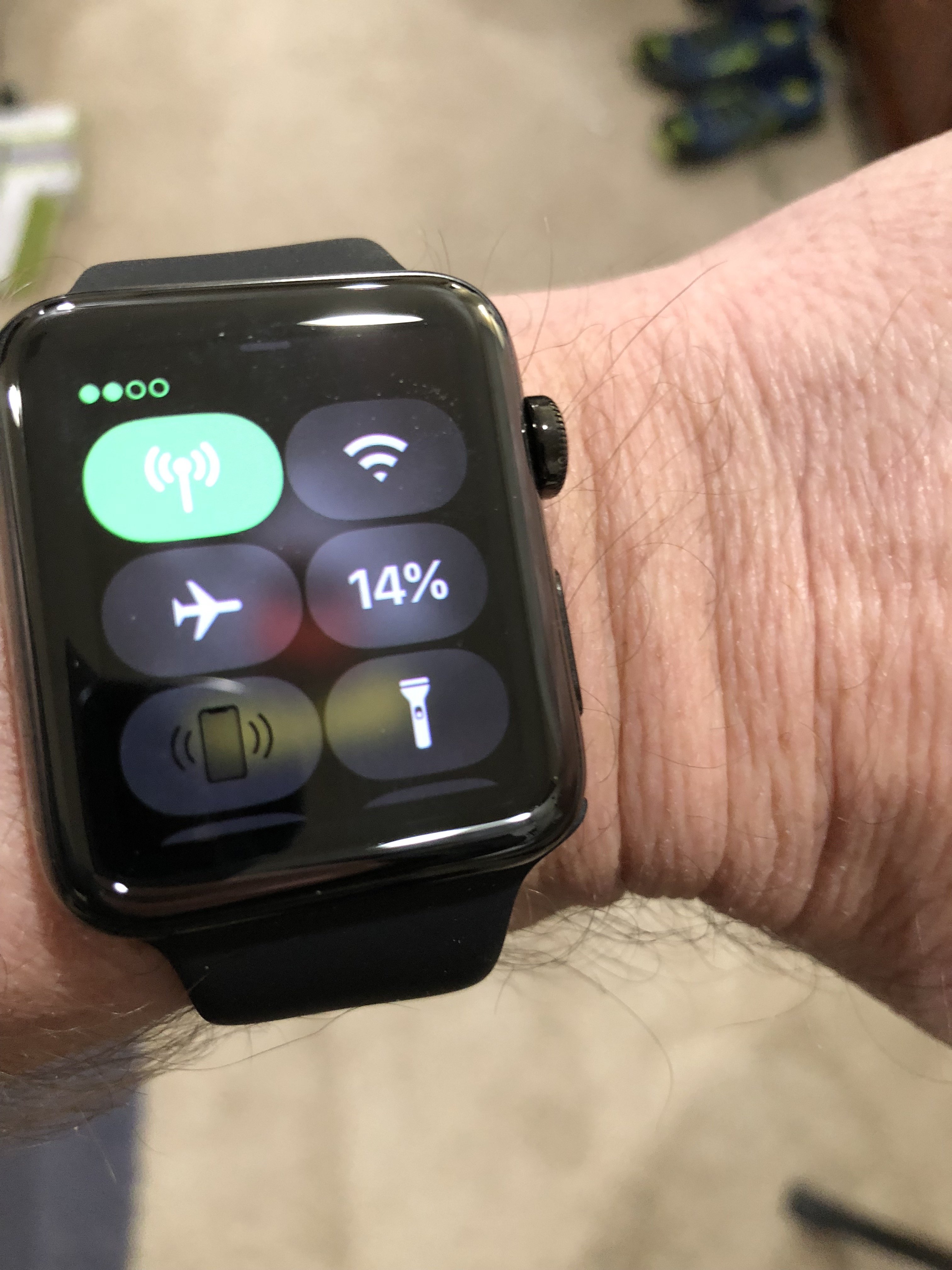

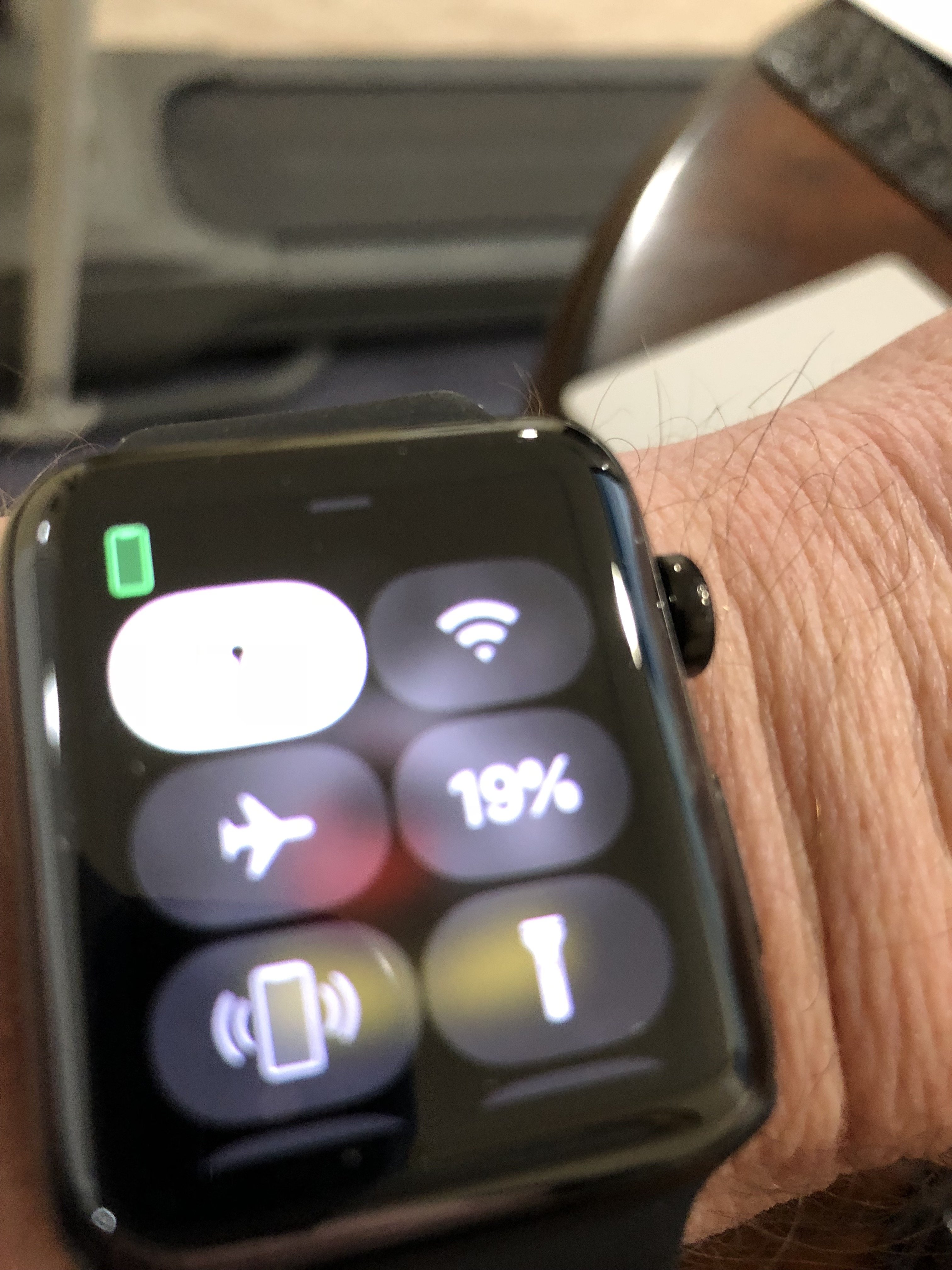

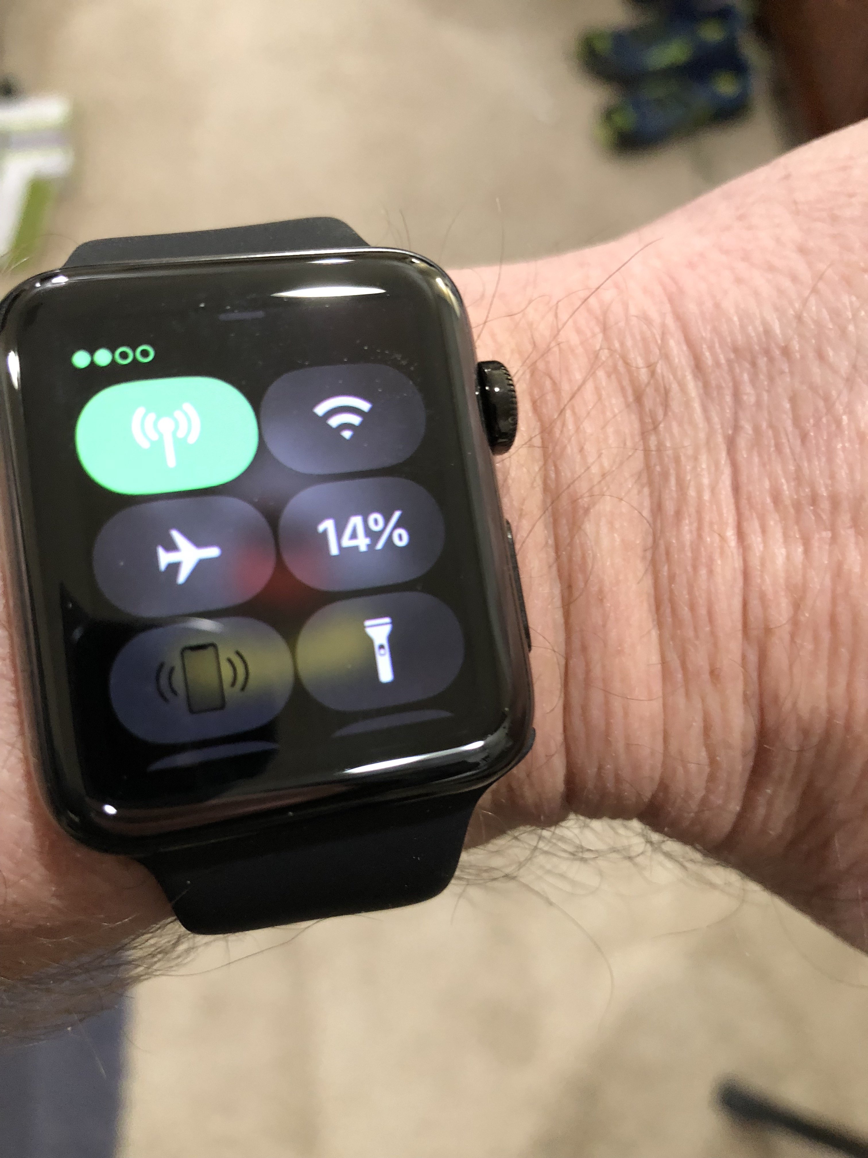

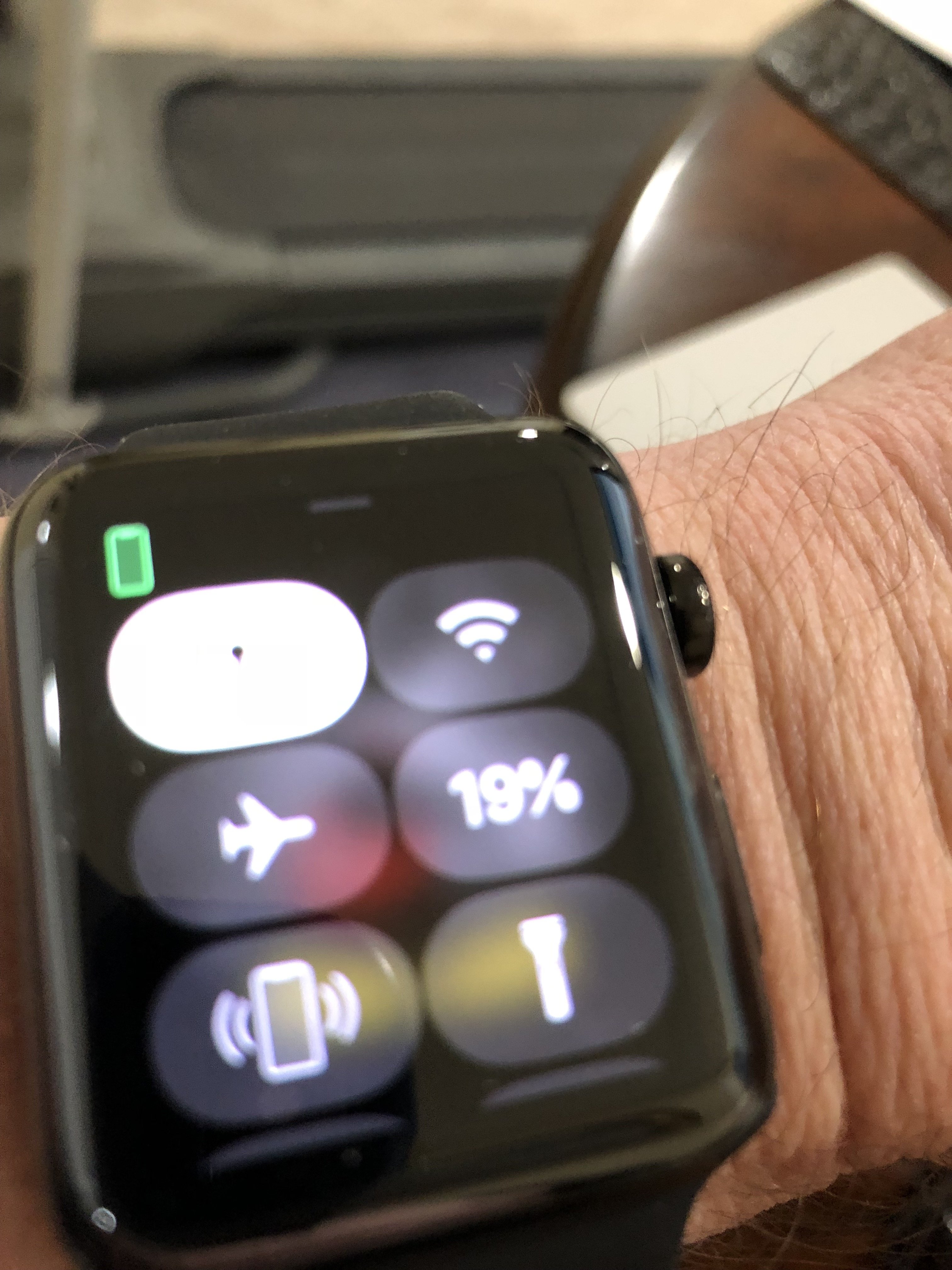

This is what my watch looks like with my phone in airplane and wifi turned off on the phone.
I put the phone in airplane and the watch (with wifi off) isn't answering.
Edited to add: I forgot that I have my phone use 5GZon my Airport Extreme. That would explain why the watch couldn't call or receive. Once I saw that, turned off wifi and made sure cellular was connected to the watch, it went through. It completely slipped my mind that the watch only uses LTE as the last option. Much different than the phone. Glad I got that cleared up.
