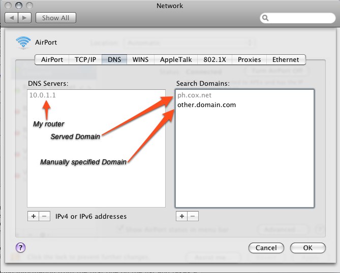

At the client side:
DHCP, no DNS entry - will ask for an IP address and the DNS server to be used, populated automatically from the router
DCHP, manual DNS entry - will ask for an IP address and will attempt to pass network requests through the DNS server specified, but "should" find other DNS servers on the network you're attached to.
The router acts as the DNS Server for devices downstream from it and provides the domains to be searched. You can specify additional domains, but the order they appear sometimes can cause a lot of delays while it's attempting to get routing information from the first one on the list and takes a while to time out and move to the next one.

At the client side:
thank you, this is exactly what i'm talking about.
now how can i get my dns info to be populated automatically like yours?
