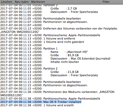

[doublepost=1499120467][/doublepost]I just reformatted my drive and the disk utility log indicates that even though there is no seperate checkbox even OS 10.5 installs OS9 drivers
I'm sorry that it's german but it basically says:
- prepare for partitioning
-partition scheme Apple partition table
-Mac OS 9-driver installed
-1 volume created
So the OS9 driver is partition related after all and shouldn't be the problem

As mentioned above OS X seem to install the drivers itself, even for a single partition. That's the log after I resized a partition and created a second one.

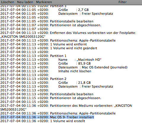

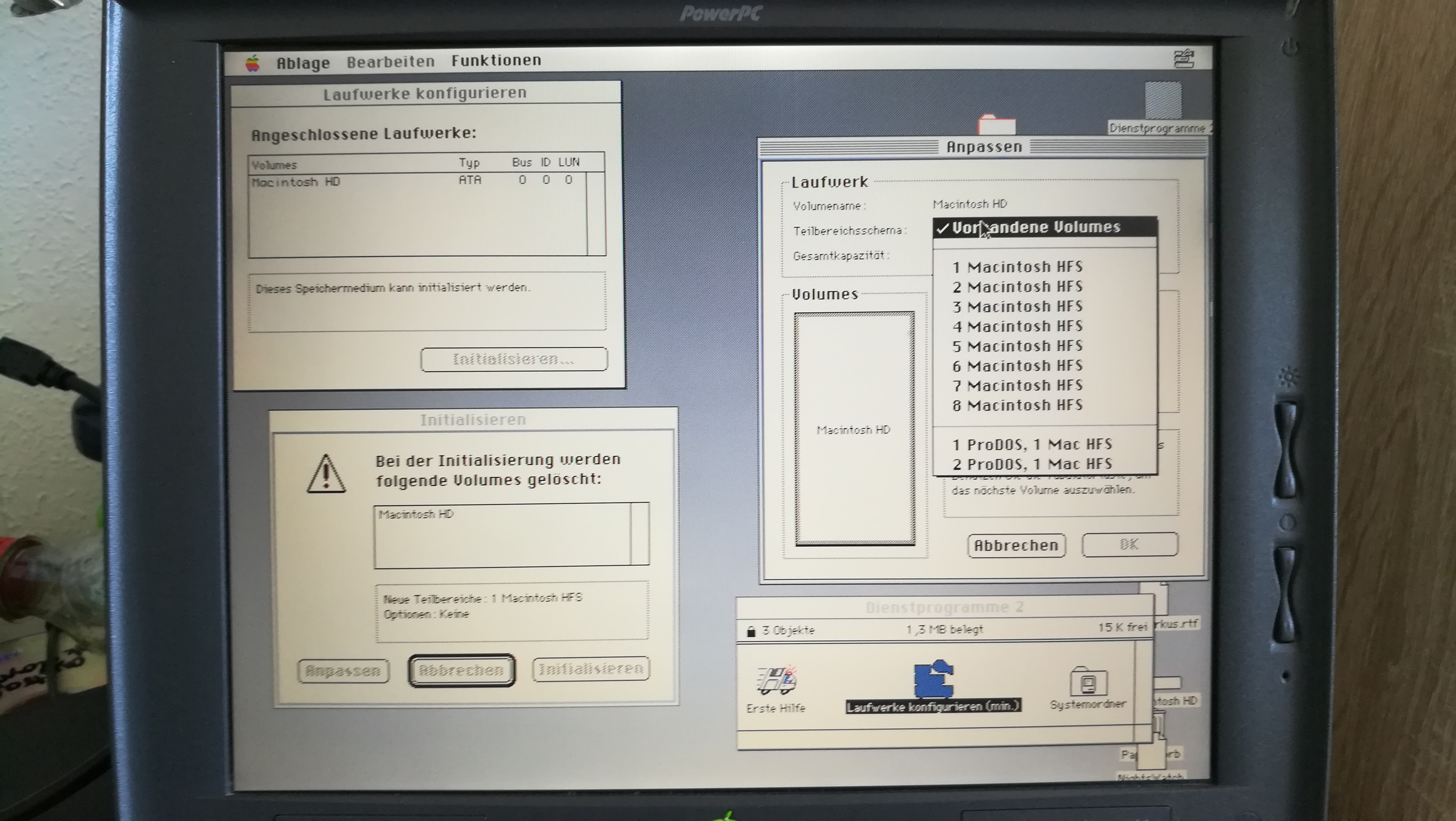

Almost took the leap of faith but Drive Setup only saw 128GB of my 160GB HDD when I went into the options section when I was going to initialise the drive..
That's weird... you are still trying this on the G4 PB? 128 is the G3s limit...
You made me very curious now, maybe I'll give it a try on my iBook tomorrow
I used the Utilitys Floppy Disk (7.5) to boot the powerbook and that's what drive setup looks like there.

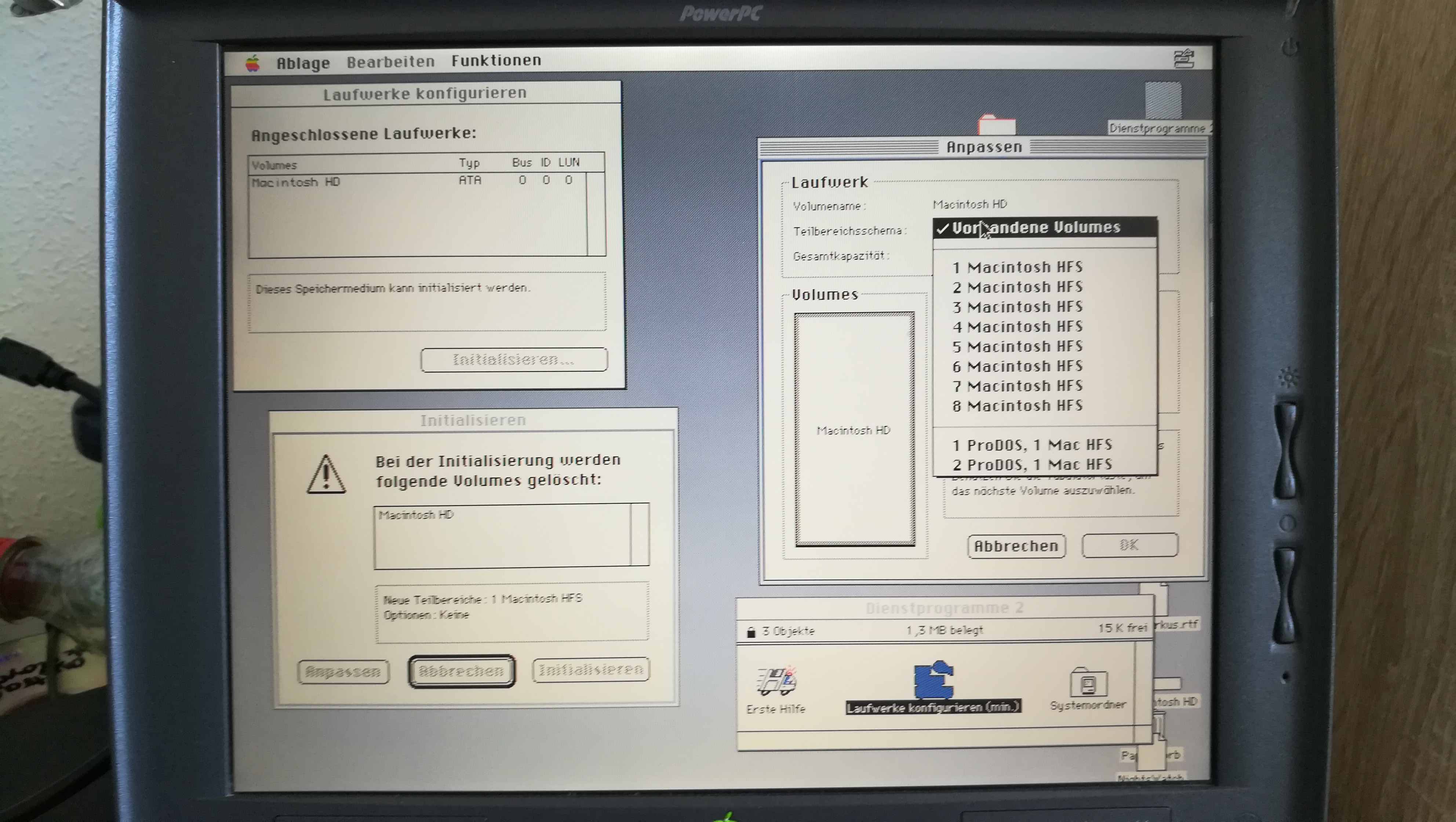

Maybe format the drive in OS9 as two partitions, then boot with OS X DVD and hope that it recognizes the drive properly

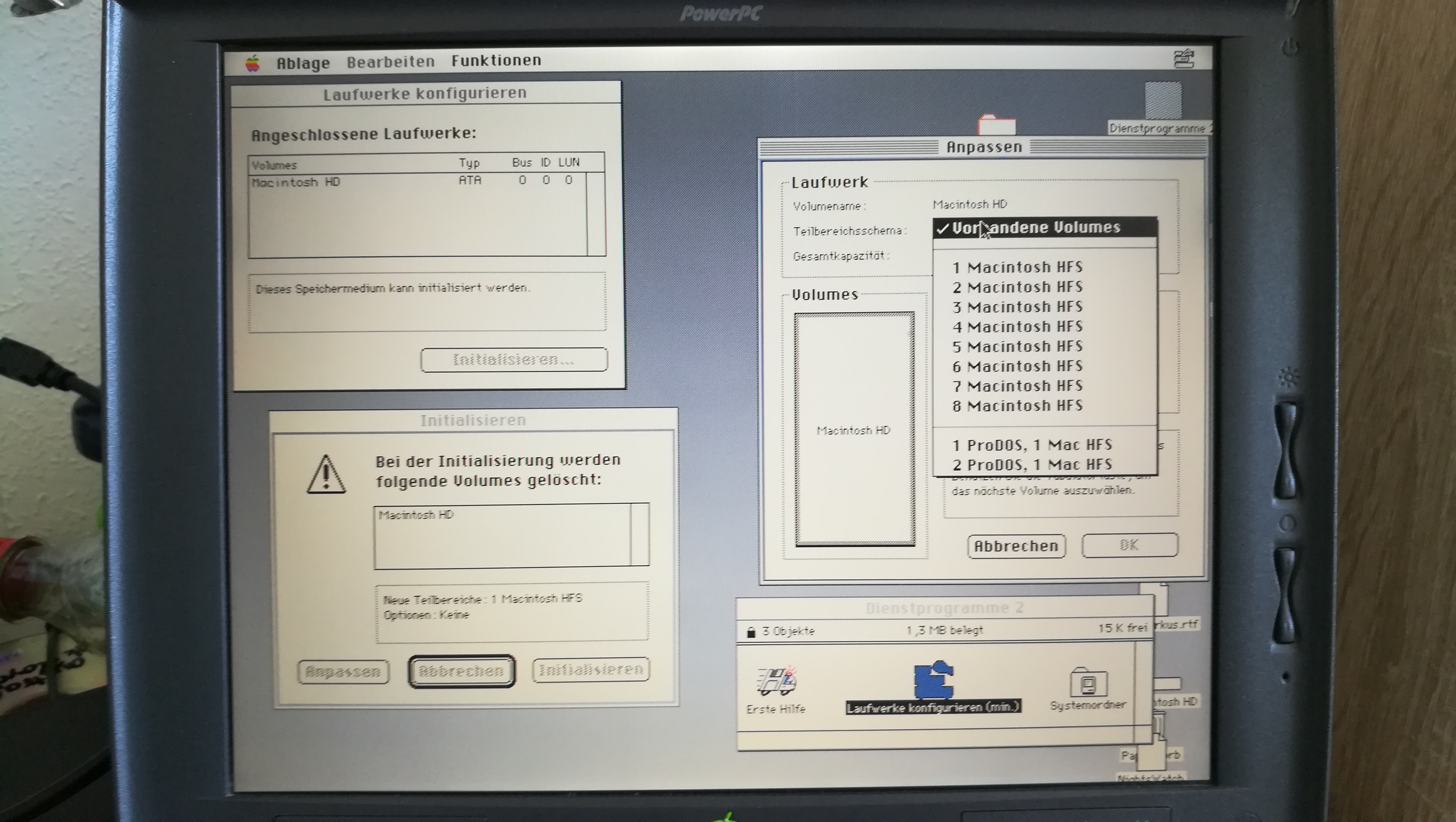

Yeah, I plan to boot OS X 10.5 (and maybe 10.4) and OS9. I'm still concerned about the 128GB limit tho.. Don't want to waste 32GB I think I'll try with disk utility via terminal
Two ways around this.
Partion as two drives or Intech HiCap driver (supports OS9).
Surely not gonna buy a driver for something that should work out of the box. Drive Setup only sees 128GB, even when I choose to do multiple paritions. I think I'll save myself the hassle and be content with Classic environment as sound is wonky on OS9 (only works if headphones are plugged in and then both speakers and headphones output sound). Maybe I'll try looking for some cheap laptop locally if I decide to dabble with OS9 more or I'll just use it via a USB pen drive
