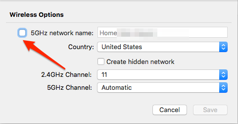

Open Airport Utility and in the wireless tab click wireless options at the bottom then make sure this box is UNchecked. It sounds like it is checked and you setup a separate 5GHz network. I don't think this would have anything to do with El Capitan though.

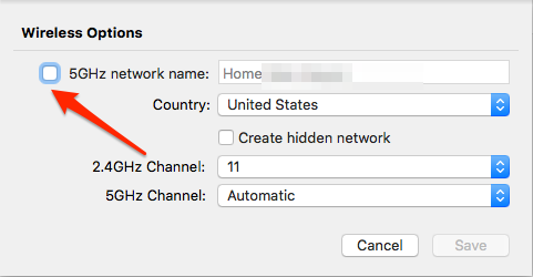

Thanks Weaselboy. I do see the option to check/uncheck the 5GHz network name (and yes, it was checked by default, although I never remember touching that ever). And no one else has access to my network passwords, etc.
But now my question is: if I uncheck that box, that means I will only have a single "network name" (in this case, it will simply be AirportOne). Will that single network operate as a 2.4 or a 5GHZ network? Or does the "single network" become a dual-band network, and the devices (like my iPhone and iMac) connect to the highest possible frequency when possible?
In the Wireless panel the 2.4GHz Channel is set to Automatic, and the 5Ghz Channel is set to Automatic.
You must have set that and just forgotten. I can't think of any way someone could get in there and change that on your from outside the network.
Yeah... if you just uncheck that it will broadcast both 2.4 and 5 under the same name and the router will assign which is best. That is what I use and it seems to work well.
