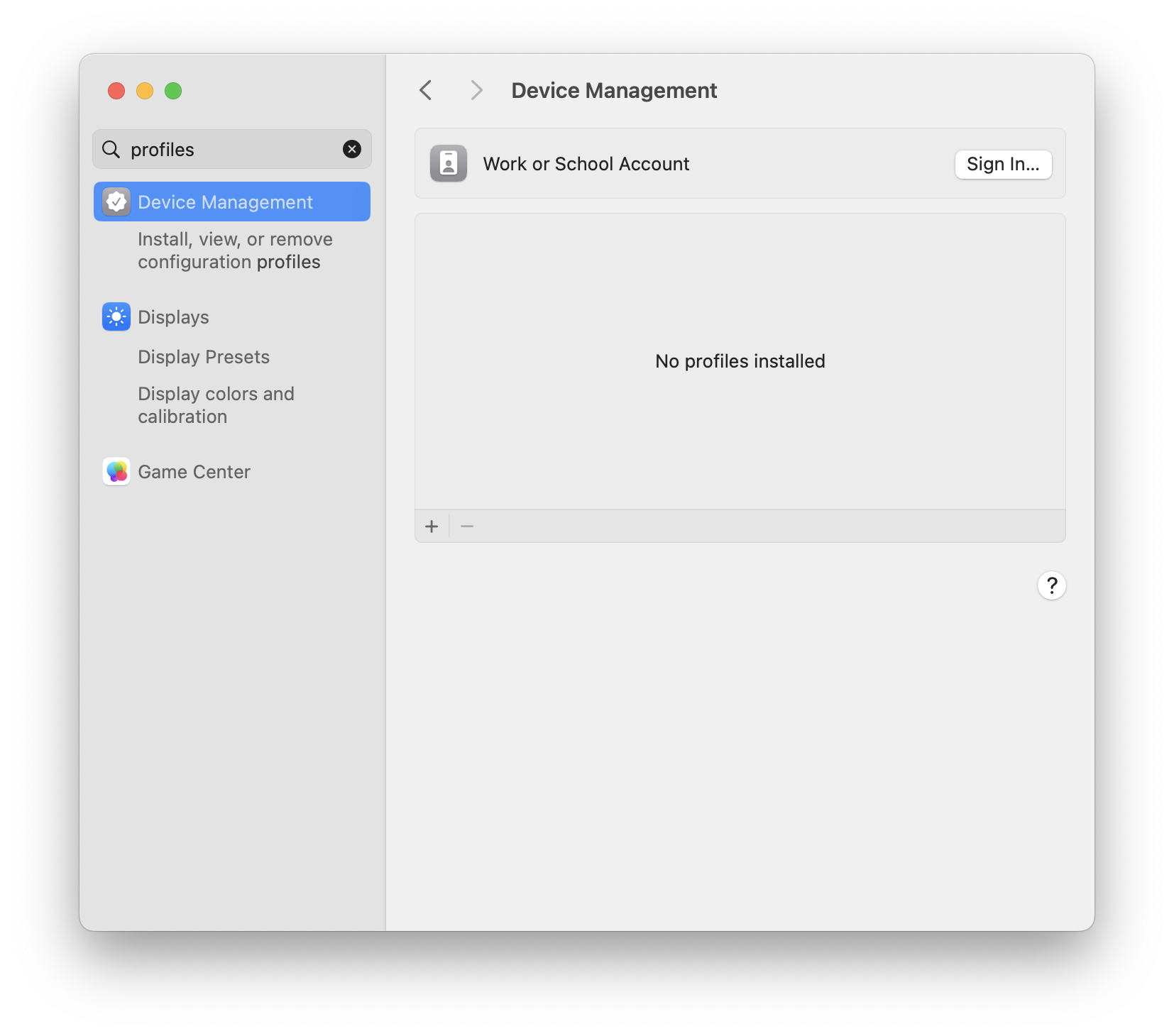

I'm not so sure about MDM. I think it survives activation lock. But it's easy to see if any MDM profiles are installed by looking in System Settings.

But if I check the device management in the system settings (shown above) I should be good to go? Or is this a phantom mechanic
There is a possibility that it will not show anything in system settings if the initial enrollment was bypassed or if MDM was temporarily disabled by the computer's actual owner.
With an internet connection and while signed into an admin account you can run this in terminal:
Sass:
sudo profiles show -type enrollment
If the computer is not currently enrolled in an MDM you'll get an error message that says that the "Client is not DEP enabled." This is not a 100% certain answer as to whether the computer is managed. That can only be determined with certainty by looking the computer up in Apple's GSX service tool which is not publicly available.

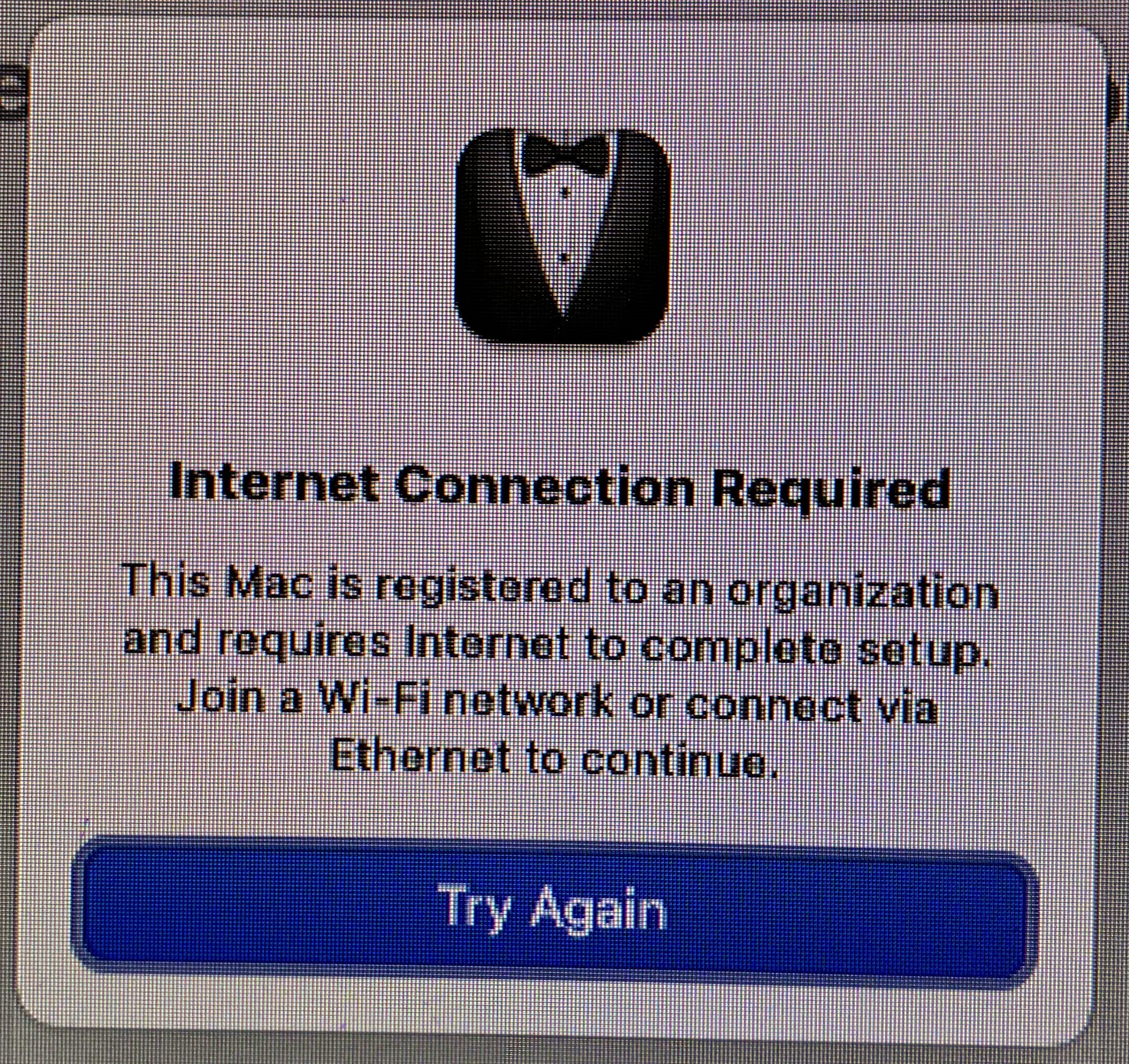

Some MDM bypass methods make it invisible here. The only way to know for sure whether there are any is to Erase All Content and Settings and go through the initial setup again. If you try to finish it without internet and get a popup saying “Internet Connection Required This Mac is registered to an organization and requires Internet to complete setup. Join a Wi-Fi network or connect via Ethernet to continue.” then bad news. Ask me how I know 😭
