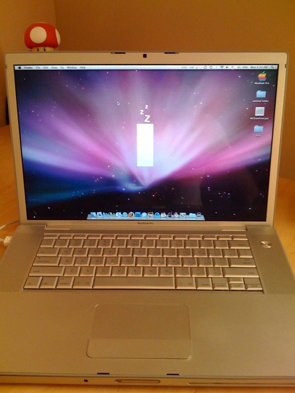

I've read you can put the macbook pro to sleep using the Play button and holding it for 3-5 seconds it'll dim and show a picture of a Apple Remote with ZzzZZzz's about it and then go to sleep.
Ok so I tried this and it worked fine when to sleep and LED started to blink, my question is, the pictures of seen and guides i've read said a remote with the zZzZZz's above it should show right before it sleeps, I never see this? Is it a option you turn on or did I do something incorrectly?

I get it on my previous gen MBP as well (2.16 C2D)
Im just trying to figure out if it's because my macbook pro is a older model, and it only showed up on the newer models? But wouldnt it just a a software based thing?
I've got the older model, too (silver key MBP, early '08), and I get the ZzzzZzz picture too.

I have an early 2006 MBP, the first ever made. I get the remote Zzzs.
You probably have a messed-up system install that's missing the image file? Try reinstalling the latest Front Row update from apple.com/downloads.

You're not supposed to get the Zzzzz icon if you sleep the machine from within Front Row. Is that why you're worried? Or do you not get it even if you sleep it from the Finder?
