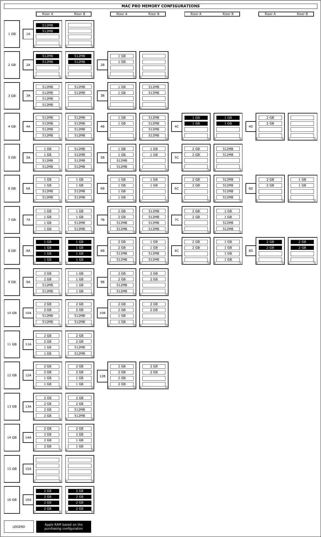

So… in a week or two I'll hopefully receive my newly ordered BTO 4-core Mac Pro. (I'd have waited for Penryn, but I absolutely can't. 🙁)
In addition to the stock 2x512MB sticks, I've ordered 4x1GB of the Netlist RAM from OWC, which will probably end up arriving some time before the actual Mac Pro.
Now, I've read up on the general RAM placement guidelines (matched pairs always together, etc.), but I'm still wondering whether I should take out the stock RAM or leave it in for a total of 5GB. I've read posts saying that having the smaller RAM sticks in there will actually slow down performance. Is this true? Which RAM placement will get me the best performance?
Also, if I do leave the stock RAM in, where would people recommend I put it? The options are either together with two 1GB sticks (i.e. Riser A: 512/512/1024/1024, Riser B: 1024/1024) or on a separate riser with all the 1GB sticks together on the same riser.
Help appreciated.

here it is.....
so just to be certain....my Mac Pro came with four 512MB sticks, two in riser A and two in riser B. I just bought two 2 GB sticks and installed as follows:
Riser A: pair of 2 GB, pair of 512 MB
Riser B: pair of 512 MB
Looking at the schematic, it appears that I should have done the following:
Riser A: Pair of 2 GB,
Riser B: Pair of 512MB, Pair of 512 MB
Is this correct? If so, why?
It is to do with memory bandwidth. You get maximum bandwidth (quad channel/256 bit) when memory is accessed from both risers. With both pairs of 512MB memory on riser B this means you can access a total of 4GB of memory at full bandwidth (2GB from each riser), and a further 2GB at half bandwidth. With how you currently have it you would access 2GB at full bandwidth and 4GB at half bandwidth.
I switched to the memory confirmation as noted above: two 2 GB sticks on Riser A (the upper one) and four 512 MB sticks on Riser B (the lower one) and my Power Mac refused to start, just blinking the light above the on-off switch. I switched back to my previous setup: two 2GM and two 512 MB sticks on Riser A and two 512 Sticks on Riser B, and it works. Looking at the schematic on the inside of the Mac Pro case, my setup is recommended.
Can you explain what happened. When I check "This Mac" setup, all is well regarding memory, ie 6 GB distributed on the appropriate Risers.
What you saying is that only a full riser gives maximal bandwidth and a half full riser gives 1/2 bandwidth, so, with my present setup, I'm getting only 1/2 of my additional 4 GB memory and the full 4x 512 or 2GB on riser B, equalling 4 GB total.
I want to maximize my speed. Do I need to buy two more 2GB sticks? Is there a problem with Riser B?
I'm confused and a bit frustrated.
Please advise.
Ok, you will have 6GB no matter how you arrange them on the risers. It is the speed at whcih the memory interacts with the system that is affected by how they are placed. The chart posted is mostly theoretical I believe, so it doesn't actually mean that 2x2GB on A and 4x512MB on B will work.
I wouldn't worry about it too much. Capacity will nearly always come before speed for most people's usage. 512MB DIMMs can drag down peformance due to being single ranked rater than dual as other DIMMs are and because of their small size. I can reccomend you go and get another 2x2GB and ditch the 512MB sticks, but you're then looking at another $100 and all it may end up giving you in reality is peace of mind.
