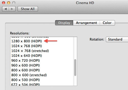

    Actually, yes, you can. This has been discovered even before rMBPs were announced.
    You will need to be registered as an Apple developer (free) in order to download Quartz Debug which is part of the Xcode tools.
    You will find Quartz Debug in a .dmg called "Graphic Tools" once you are logged in on the Mac Dev Center.
    Open Quartz Debug, then click on Menu -> UI Resolution and check “Enable HiDPI display modes”.
    Log out of OS X and back in then when you will go in the Displays section of System Preferences, Retina (HiDPI) resolutions will be listed like this:
    [​IMG]
    Of course you will lose screen real estate, but choosing a resolution such as 840 x 525 (HiDPI) will let you see Retina-optimized graphics in all their glory on your 1680 x 1050 screen.
    This is mostly for testing purpose though, as a 840 x 525 screen isn't really usable for most apps. You could also experiment with 1440 x 900 (HiDPI), but I doubt the gain would be really noticeable, as mentioned. You're free to try though.

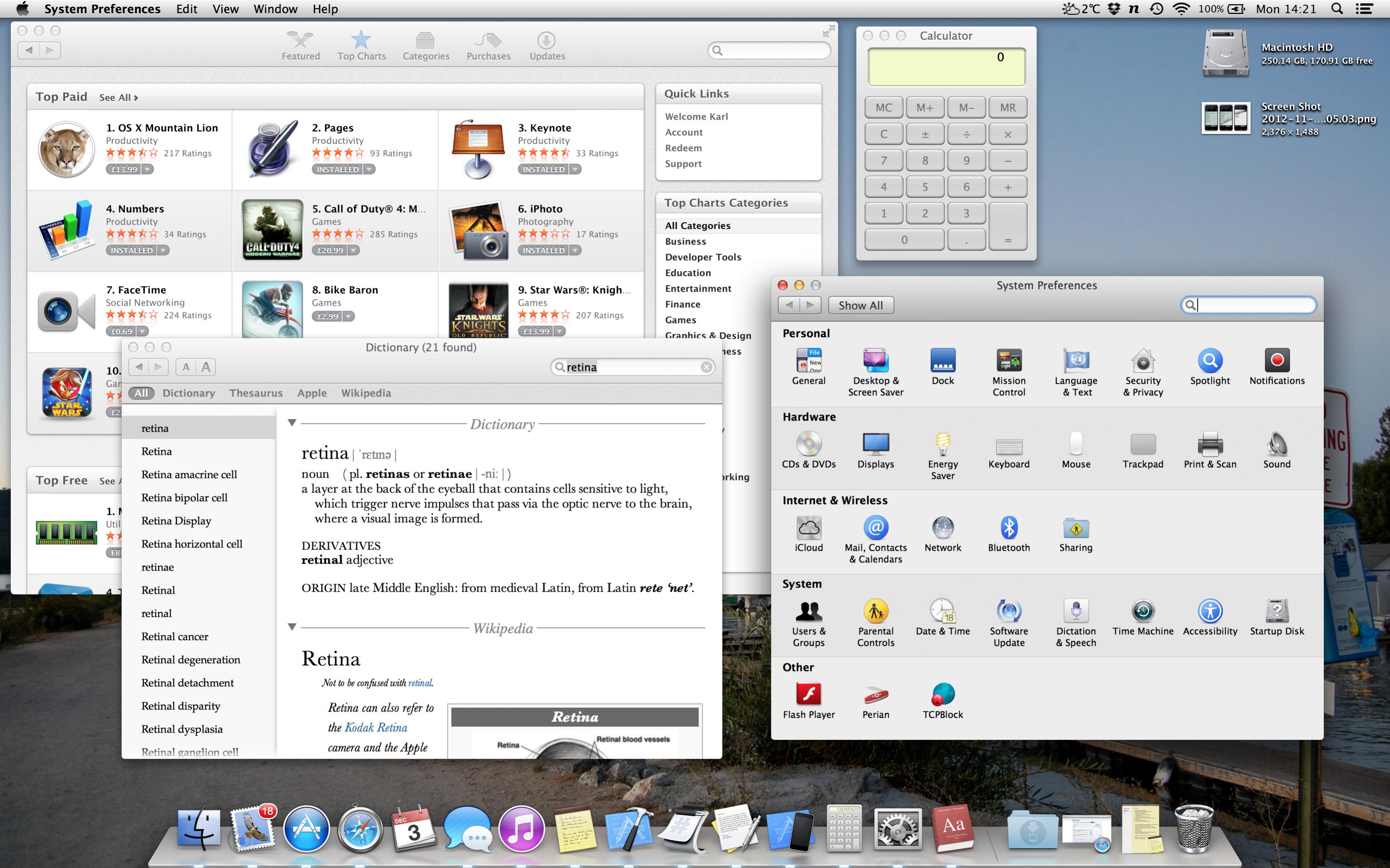

    If you're a developer and you're asking if there is a way to test how your app will look on a retina screen (to make sure you've not left anything out), you can use Quartz Debug to enable it.
    If you're not, don't worry about it. It wouldn't even be "pseudo-retina".
    The retina monicker refers to the combination of having an extremely pixel-dense screen and higher resolution graphics. This allows you to use graphics with more pixels (hence detail) but which are the same physical size.
    If you just enable Hi-DPI mode, the physical size of things on your screen would be enormous.
    If you just had an ultra-dense display, the physical size of things on your screen would be tiny.
    Basically, they go together. Only having either one separately makes your viewing much less comfortable.
    You should also note that the scale factor for Hi-DPI mode is pegged at 2x. It's not possible to change it to some non-integer value. That would come with a big performance hit - pixels would not align and adjacent pixels would need to be blended and averaged together. That averaging process is just going to blur the details and negate the benefit of scaling at all.
    I've attached a screenshot from my RMBP. Click it in Safari to open it and click the opened image again to zoom 100%. Look at the physical size of each button and window on your screen - that's how big it will be in Hi-DPI mode on your machine.
