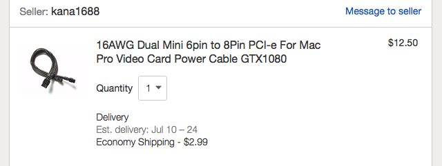

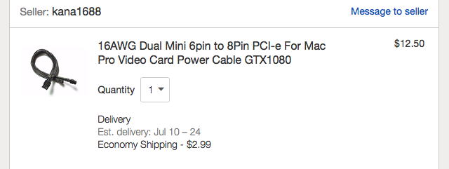

I just did this and bought a dual mini 6 pin to 8 pin from eBay. Works a treat
Two of them?!
Wrong, you need a Y-shape cable, merge both mini 6pin output to a single 8pin input.
Shoot okay.
