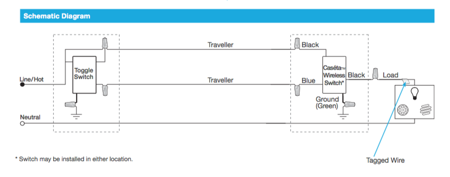

Just went through this on Friday with Lutron caseta:
http://www.casetawireless.com/Documents/0301710 - 3-way.pdf
FWIW, my implementation is paired with traditional toggle switch (last three pages above link)

[doublepost=1511284779][/doublepost]Actually, I take it back. After looking through those Lutron instructions this might be a thing. I didn't know you could simply unwire one of the switches and install the remote in its place. That actually solves my problem and the remote comes with most of the Lutron kits I've been seeing. In that case, I'll only need two kits.

I've been using Leviton HomeKit switches because I don't want another hub, or batteries, and dimmable at all locations.
However skimming the directions of the Lutron you can use an existing 3 way switch in combination with the Caseta Wireless switch. Basically you'll just need to make a 3 way switch a single pole and send a constant 120v to the wireless switch.
