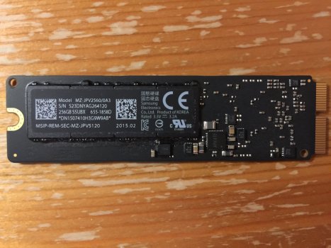

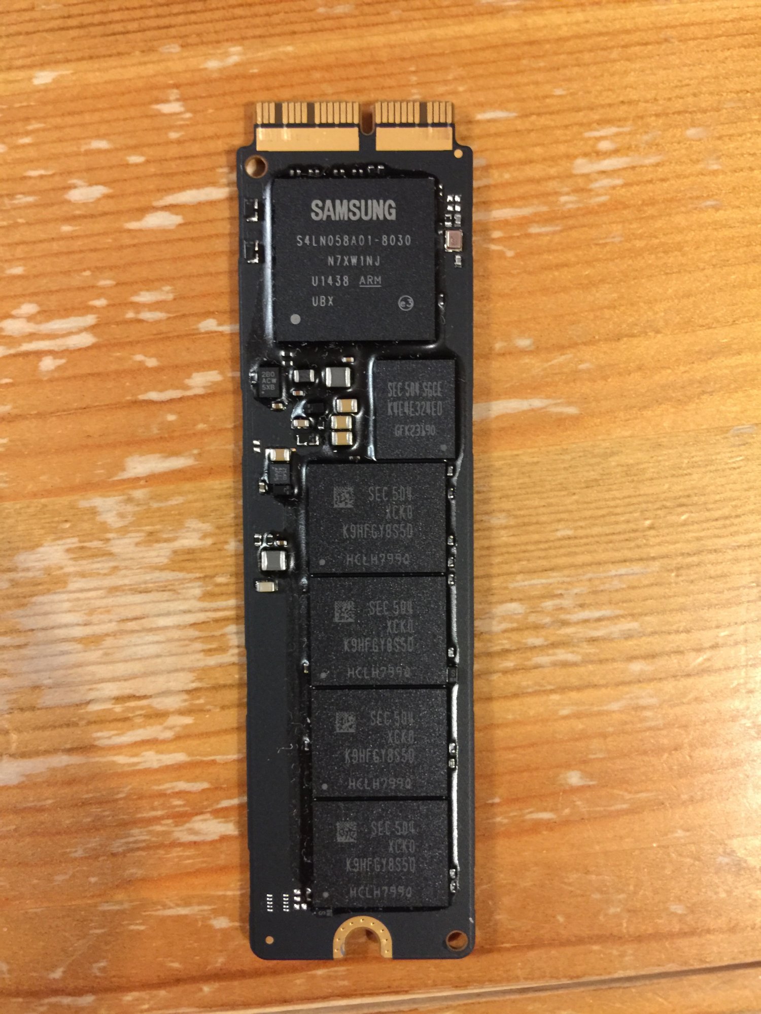

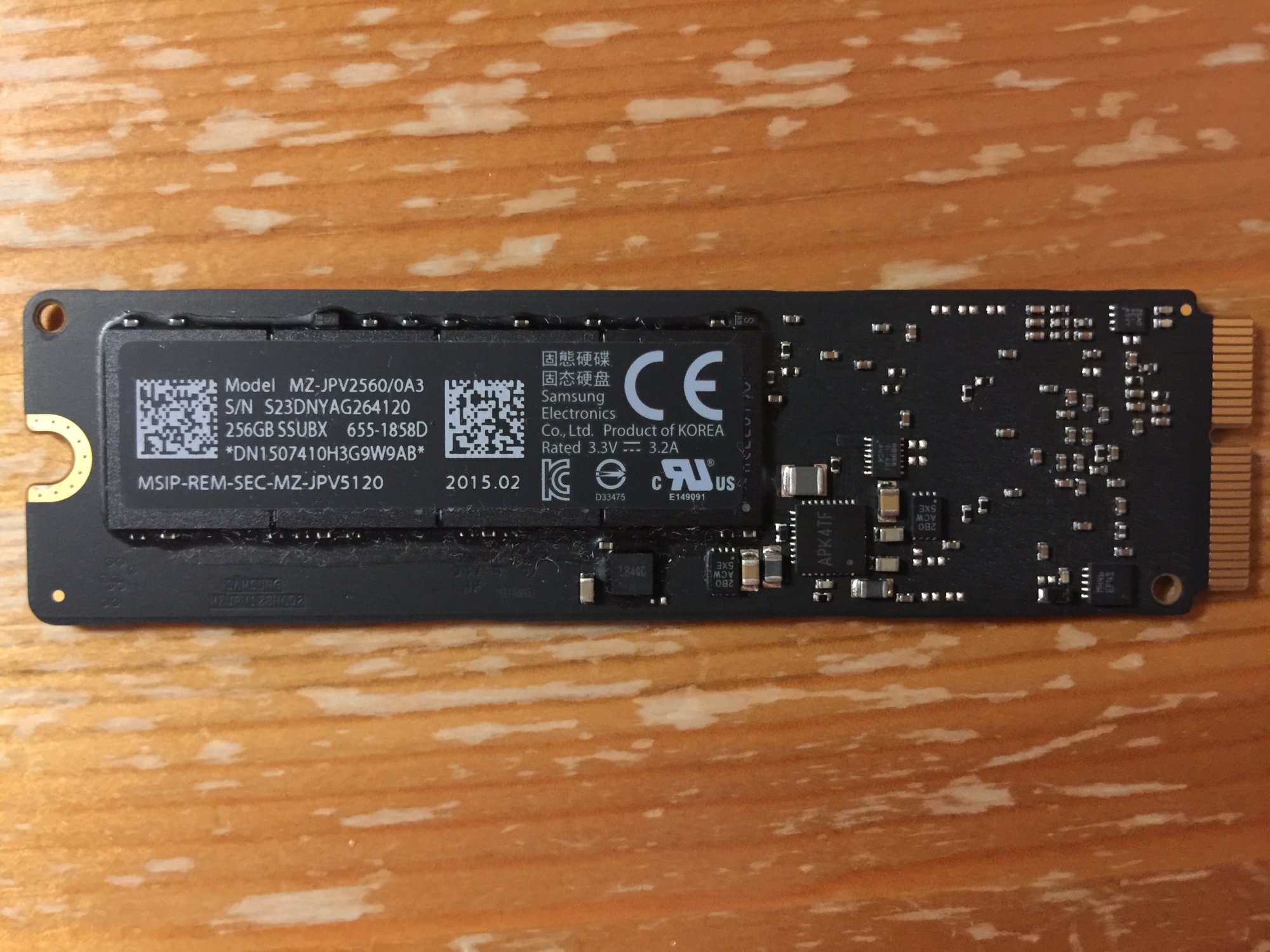

Thank-you for your reply. I’m not 100% sure, but from what I could gather, there seem to be very few enclosures that are compatible with the hard drive from my MBP and they were £50, £80 or more (I’m in the UK.) I think Apple used a proprietary 16 + 12 pin connector in this model, so most cheap enclosures don’t work with it.
I’ve included pictures of both sides of the hard drive; if anyone knows for sure if I’m right about this, or can correct me if not, it would be much appreciated!
I had a 2014 rMBP. Yes, appears there's not much of a market remaining for those ssd's. You want AHCI compatibility. That's the proper pin configuration. There are plenty of cheap converters that will get you there. But this may be a better answer for you:
If not specifically available in the UK, it will provide a benchmark of what will get you migrated.
"$10 and 2 minutes work: mount the drive in a cheap external usb enclosure. YouTube to see how it’s done."
There's one problem:
The proprietary-design drive from a 2014/15 MacBook Pro WILL NOT FIT into a "cheap" USB3 enclosure.

It's important to confirm the exact year of your Mac.
A1502 covers MacBook Pro (Retina, 13-inch, Late 2013) to MacBook Pro (Retina, 13-inch, Early 2015). An SSD pulled from any of these Macs will work in any of the others (the 2015 were faster but the connector was the same), as well as a MacBook Pro (Retina, 15-inch, Late 2013) to MacBook Pro (Retina, 15-inch, Mid 2015), all of which are A1398. However, an A1398 could also be a MacBook Pro (Retina, 15-inch, Early 2013) whose SSD is different.
All that said, it should be as simple as popping in your SSD and booting up (only other issue could be if your parent's Mac never upgraded to High Sierra and yours did, as that introduced APFS formatting - if this is an issue, their Mac can be upgraded to High Sierra for free).
