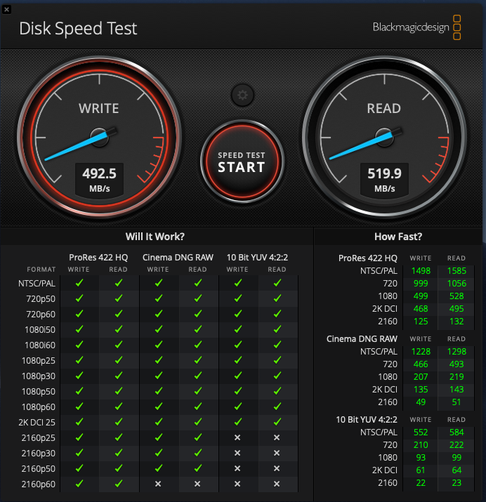

Here is my Black Magic result for a 500GB T5 using USB-C:
I had similar results (Corsair SATA SSD in a gen2 case) connected to the type-a port. I think this isn’t great to test this particular issue because sata tops out at 6Gbps anyway - you won’t see much improvement.

I've had pretty good luck with relatively inexpensive enclosures based on the ASMedia ASM1352R bridge chip, which offers dual SATA ports and RAID functionality. With a pair of 500 GB Samsung SSD 850 EVOs in RAID 0, I was able to clock 902 MB/s sequential read and 854 MB/s sequential write speeds in AJA System Test.
The drives individually were able to hit up to 529 MB/s read, 498 MB/s write over a USB 3.1 10 Gbit/s connection, versus hitting a brick wall at 434 MB/s when connected via 5 Gbit/s USB 3.0. So even fast SATA drives can still gain a little from the extra bandwidth that USB 3.1 offers.
