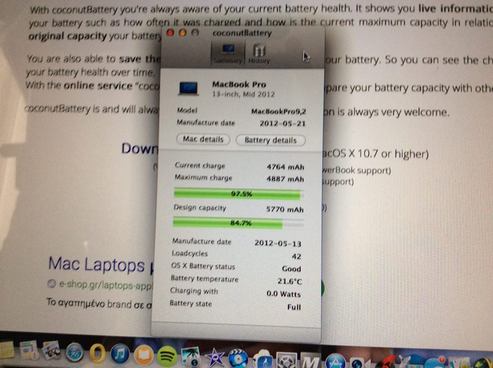

I am about to buy a used macbook mid 12. The owner sent me the picture of his battery condition and it says 42 load cycles, but the battery health is 84% and the maximum charge is under 5000 mah, is it normal? Also the battery state is full but the charge is at 97%, is there any problem? I want to have this macbook for years and i need the battery to last for hours, is this battery in good condition or it will need change soon? I attach the photo of the battery condition. Do you see anything strange?
Thank you

That capacity is a bit low. 42 cycles in 2 years, looks like they used it plugged in all the time which can diminish capacity. If it's a good price, a replacement battery is about $100.
By comparison I have a 2010 macbook air here which has 336 cycles and is at 89.6%

The price is not that much low, and i dont want to change battery soon. I would like to see answers to your questions because i have exactly the same!
