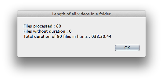

Try this :
Code:
-- time the following operation:
--set start_time to (time of (current date)) -- start timing
set this_folder to (choose folder with prompt "Pick the folder containing the video files to process:") as string
set video_ext_list to {"3g2", "3gp", "3gp2", "3gpp", "3mm", "60d", "aep", "ajp", "amv", "asf", "asx", "avb", "avi", "avs", "bik", "bix", "box", "byu", "cvc", "dce", "dif", "dir", "divx", "dv", "dvr-ms", "dxr", "eye", "fcp", "flc", "fli", "flv", "flx", "gl", "grasp", "gvi", "gvp", "ifo", "imovieproject", "ivf", "ivs", "izz", "izzy", "lsf", "lsx", "m1v", "m2v", "m4e", "m4u", "m4v", "mjp", "mkv", "moov", "mov", "movie", "mp4", "mpe", "mpeg", "mpg", "mpv2", "msh", "mswmm", "mvb", "mvc", "nvc", "ogm", "omf", "prproj", "prx", "qt", "qtch", "rm", "rmvb", "rp", "rts", "sbk", "scm", "smil", "smv", "spl", "srt", "ssm", "svi", "swf", "swi", "tivo", "ts", "vdo", "vf", "vfw", "vid", "viewlet", "viv", "vivo", "vob", "vro", "wm", "wmd", "wmv", "wmx", "wvx", "yuv"}
tell application "Finder"
	set these_files to ((files of folder this_folder whose name extension is in video_ext_list) as alias list)
end tell
set filesCount to count of these_files
set total_duration_of_files_in_seconds to ""
set files_with_no_duration to 0
repeat with i from 1 to filesCount
	set this_file to (item i of my these_files)
	set this_info to info for this_file
	if visible of this_info is true and alias of this_info is false then
		-- insert actions here for: this_file
		set this_file_duration_in_seconds to do shell script "mdls -name kMDItemDurationSeconds -raw -nullMarker 0 " & quoted form of POSIX path of this_file
		if this_file_duration_in_seconds is not 0 then
			set total_duration_of_files_in_seconds to total_duration_of_files_in_seconds + this_file_duration_in_seconds
		else
			set files_with_no_duration to files_with_no_duration + 1
		end if
	end if
end repeat
set total_duration_in_hms to do shell script " echo " & total_duration_of_files_in_seconds & " | awk '{printf \"%03d:%02d:%02d\",$0/3600,$0%3600/60,$0%60}'"
set end_time to (time of (current date)) -- stop timing.
set elapsed_time to end_time - start_time
log "2. elapsed_time is is " & elapsed_time & " seconds."
display dialog "Files processed : " & (count of these_files) & return & "Files without duration : " & files_with_no_duration & return & "Total duration of " & (count of these_files) - files_with_no_duration & " files in h:m:s : " & total_duration_in_hms with title "Length of all videos in a folder" buttons {"OK"} default button 1
Note : Do not use the script on a folder with hundreds or more files. For your purpose of about 100 files it should be ok.
hmm.. I honestly tried to play around with VLC like you said, it wouldn't give me a total time. I added the videos to a playlist, I also added them to VLC library, but nothing!! Is there a way to make VLC show me the total time??

Your script is far more useful than anything on internet bro...just request to add one more feature in this awesome thing,
i doesn't want to select folder everytime to know video length of all in it...i just want to right click on any my folder and run your script as services to know total duration. Please modify your apple script accordingly to that...!!! Big big thanks in advance...!!! @kryten2

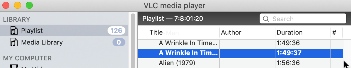

Hm. I'm using VLC Player 2.2.8 (The Luggage). If I drag some files to it, creating a playlist, the VLC window has the Title, Artist and Duration listed by default in the Playlist. Directly above the playlist there is a black bar with a Search field at the RH side. On the LH side of this bar, which is directly under the grey header bar with the 3 coloured 'traffic light' icons in the LH corner (Close, Minimise, Maximise), it is written 'Playlist -- xx:xx:xx', where xx:xx:xx is the total playing time that the app has calculated for that playlist.

Hey...even though this script is not perfect but if you try then
-Open "Apple Script Editor" from your application tray.
-Paste this code
-Save this script as "Application" at wherever location you want to save
-Then open application and prompt will say "Choose Folder"
-Now choose the folder which contains video files and you want to know total duration
-it will show you the duration.
Note- It doesn't detect subfolder, So you have to make operation separately on each folder.
Thanks to kryten2 anyway.
