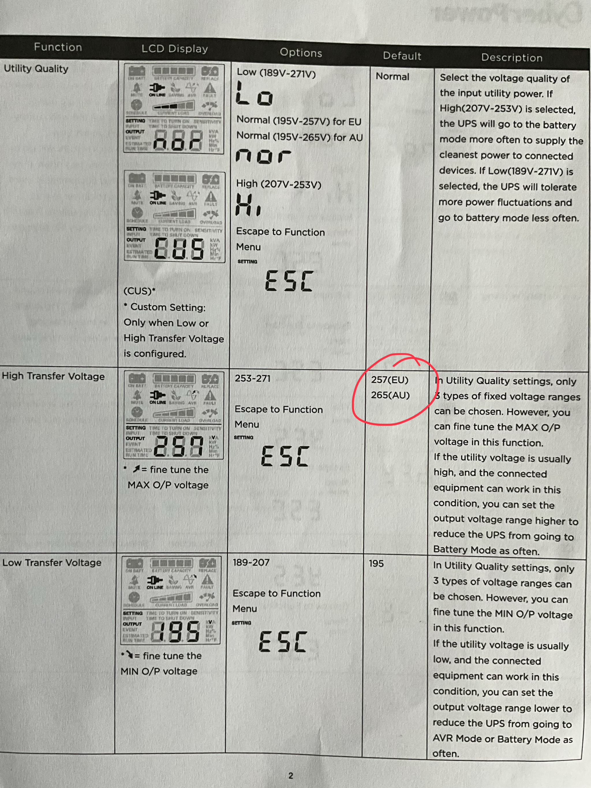

Just got a new UPS (was easier than finding/replacing my battery) to replace my 10 year old model.
The newer one ‘CyberPower CP1600EPFCLCD-UK’ has a lot more bells and whistles….. 😬
Browsing through the setup screen where you can tweak voltages etc (I tend to leave at default settings).
The setup guide shows high transfer voltage as 265 default, which looks like Australia setting (this is a UK model).
Does it make any difference using in the UK….does this need to be set to 257(EU)….?IMG_0071.jpeg
I am not knowledgeable on voltages etc….🤣
Does it make any difference using in the UK….does this need to be set to 257(EU)….?View attachment 2622946
I believe this setting is meant for you to set an upper bound for spike input voltage into the UPS, in the event the limit is exceeded, the UPS kicks in to battery mode. UK, most of EU, and AU all share the 220-240 (230)V nominal voltage, but the permitted spike range can vary.
In practice the lower the setting, the saver your equipments are, but if it enters battery mode very often it may be annoying or there are other issues arose from switching too much.
