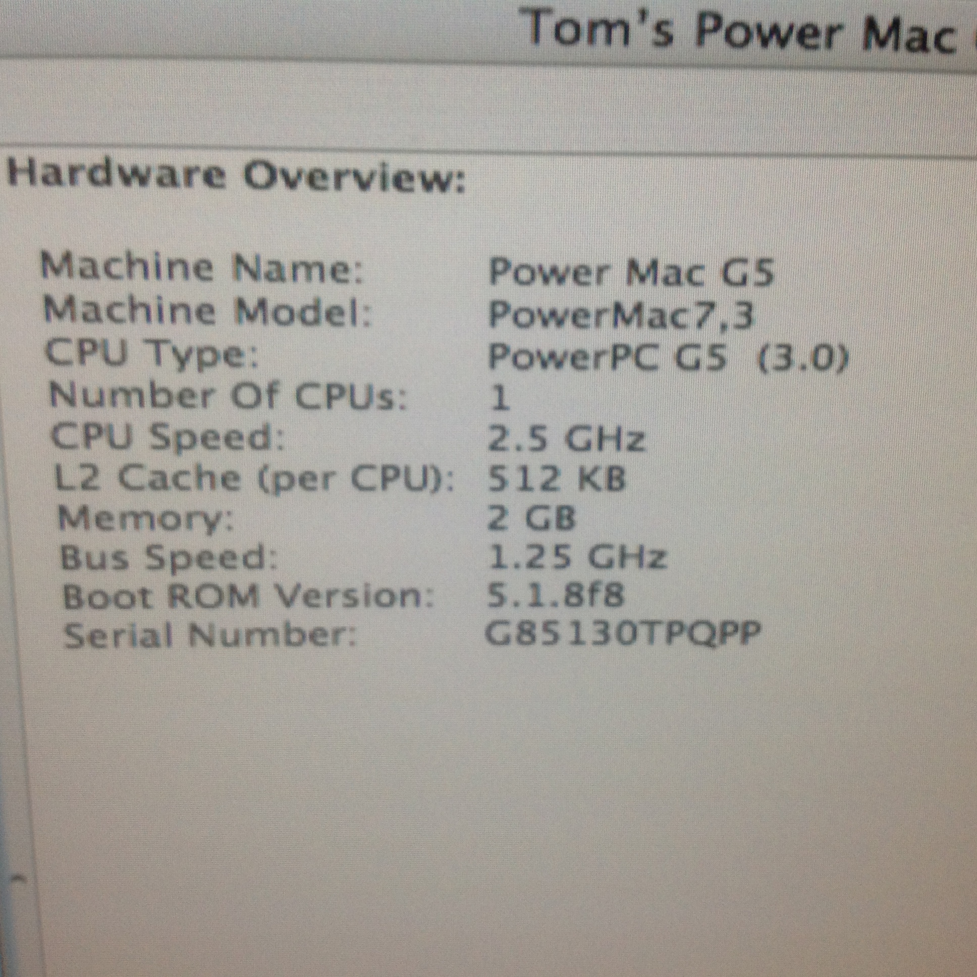

Hello,
I'm new to the forum and have a question regarding the cpu's on my G5. I have an old G5 2.5ghz running OS 10.4.9 that I purchased new in 2005 and use it for recording music only.
Here is the info on my computer:
M9457LLA G5 Dual 2.5Ghz
Power Mac 7.3
Model # A1047 Emc#1969C
I thought that this computer had two CPU's but when I looked at "ABOUT THIS COMPUTER"> "Hardware Overview" it shows only 1 cpu. Should this computer show two or one Cpu's? or is it only showing one because one has failed ? Any info would be appreciated!
Thanks
Based on the serial number and model it should have two CPUs.
Thanks for the reply! Yes, that's what I though it should show , but I contacted Apple support today and they said it should show only one. I'm a little confused, I'm about ready to order a replacement Dual Processor but I'm not sure what to do

Yeah, you're supposed to be showing 2 CPUs. Could be that one CPU has failed, or the logic board is failing. As AphoticD mentioned, its absolutely worth taking a chance on removing/reseating the CPUs to see if you've just got a bad connection at the socket. Good luck!

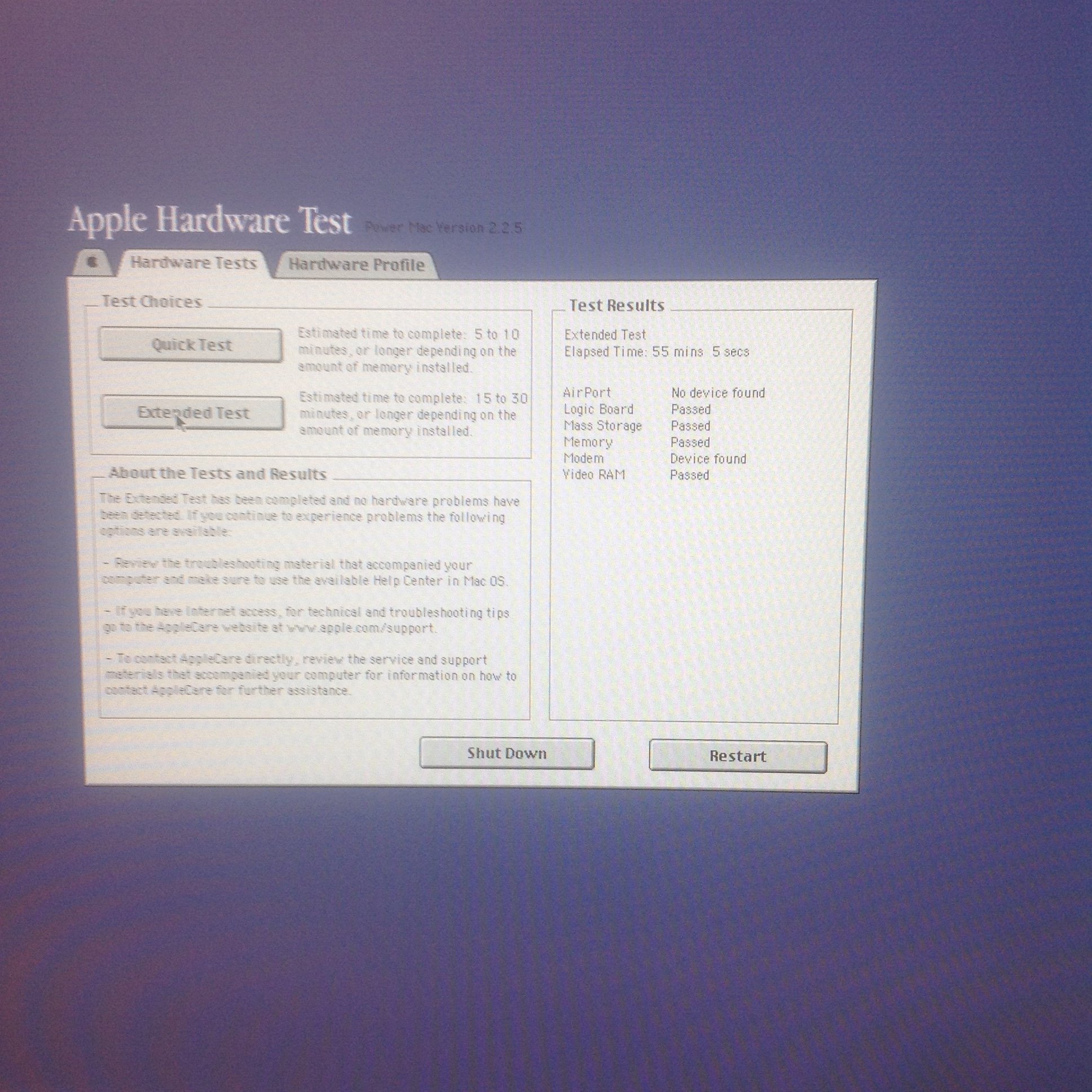

Thanks for the replies! So here's the update on my problem..
I found and ordered a new complete processor, it came Friday. I had a former Apple tech come to installed the used processor. After he ran the ASD, the system still showed only 1-Cpu. He ran some more tests and said the Logic board appears to be good, so it was probably a bad Cpu on the unit I purchased. So he pulled that back out and re-installed mine, after cleaning and re-installing the Cpu's with fresh Thermal Paste on the processor. He re-install my old unit , ran the ASD and still the same , the computer shows 1-Cpu. I located another complete processor that they give you a 60 day warranty on it. Did you think it's worth another shot or should I just call it quits. The computer is still running well on 1-Cpu, but I don't know for how long.

I wouldn't trust the ASD to save my life. Symptoms are pointing to a bad motherboard. If you're OK with the performance of running a single processor then by all means continue to use it. I recently discovered half the RAM slots in my 2.3GHz G5 are bad. I've had it for a couple of years and it's still chugging along fine (though I do not use it regularly).

I agree with trying @Hrududu ‘s idea of swapping the processors around to pinpoint the failure.
On your Dual Processor G5, each Processor Card holds a single CPU, so you want to try isolating the CPUs to determine what is faulty.
My understanding of the G5s is that the top processor socket must have a working CPU card in order to boot, so with this mind;
1. First up, use a marker to label your CPUs with A (top) and B (bottom).
2. We are expecting slot A on the logic board to be working or else the G5 won’t POST. So, confirm this by removing CPU B from the bottom socket and booting it up.
3. Shut down and remove CPU A from the top slot.
4. Install CPU B into the top slot and boot - if it POSTs okay at this point then we know both CPU cards are okay.
5. For fun, shut down and try reinstalling CPU A into the bottom slot (swapping the original config). Boot up and see if you still only have 1 CPU active or possibly 2.
This process will determine that the fault is not with your CPU cards and points to a logic board fault as per @pl1984 ‘s reply.
If this is the case, you should be able to source any of the PowerMac7,3 boards which utilize 8 RAM slots and reinstall your 2.5GHz CPU cards. Even if the logic board was pulled from a 2.0Ghz model then the system bus will bump up to accommodate the CPU cards. I understand this is a unique factor of the G5 design where the CPU cards can control the system bus speed.
