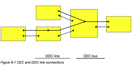

Connection schema does not impact CEC at all.
It is a single wire that connects all HDMI sockets on all devices.
Logically, TV is designed to be the hub (device #0).
