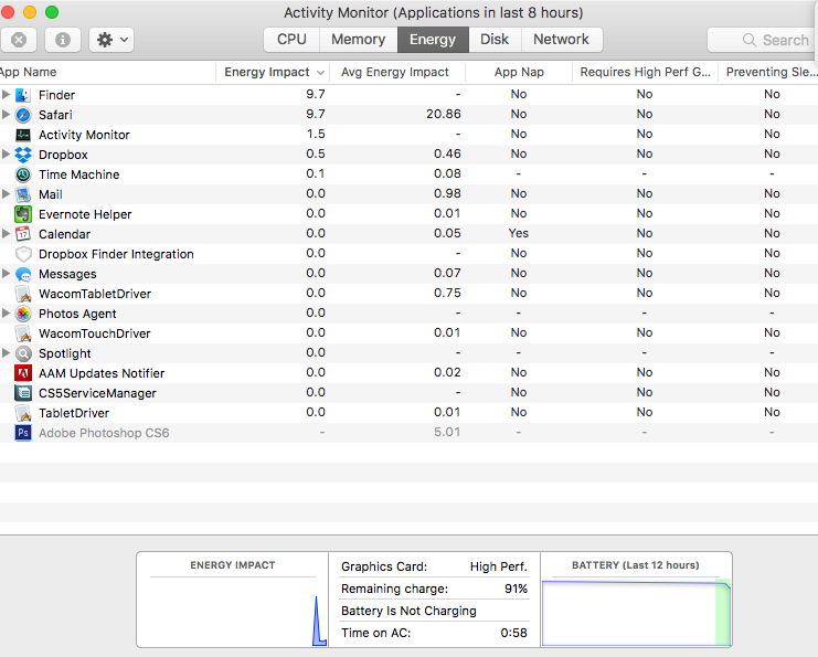

Attached is a screen shot of my Activity Monitor when I notice my battery level dropping.
I took a fast look at the product page and didn't see any specs on the power delivery rating. One possibility is that this adapter is not providing enough juice to your notebook to support what you are doing with the machine and charge the battery simultaneously. If an attached power source does not provide sufficient wattage, the Mac will draw from battery to make up the difference.
The 15" 2016 pro comes with an 87 watt power adapter, I would find out what wattage throughput this adapter supports. Again, I didn't see it after a cursory scan of the product page...
Does your Mac charge properly when connected directly to the power source via the same port you use this adapter with? If so, an issue with the port is most likely ruled out, and the problem is with the adapter.
That's my guess as well. I think the Multi Adapter only supplies 57 watt power. So I guess I have to deal with this. My only concern was the one time it drained to 0, I nor the Apple Genius was able to start it back up, thus they replace the logic board. After the repair, when it did drain to 2%, I quickly unplugged the adapter and used the Apple supplied power adapter only, and it started charging up again.
