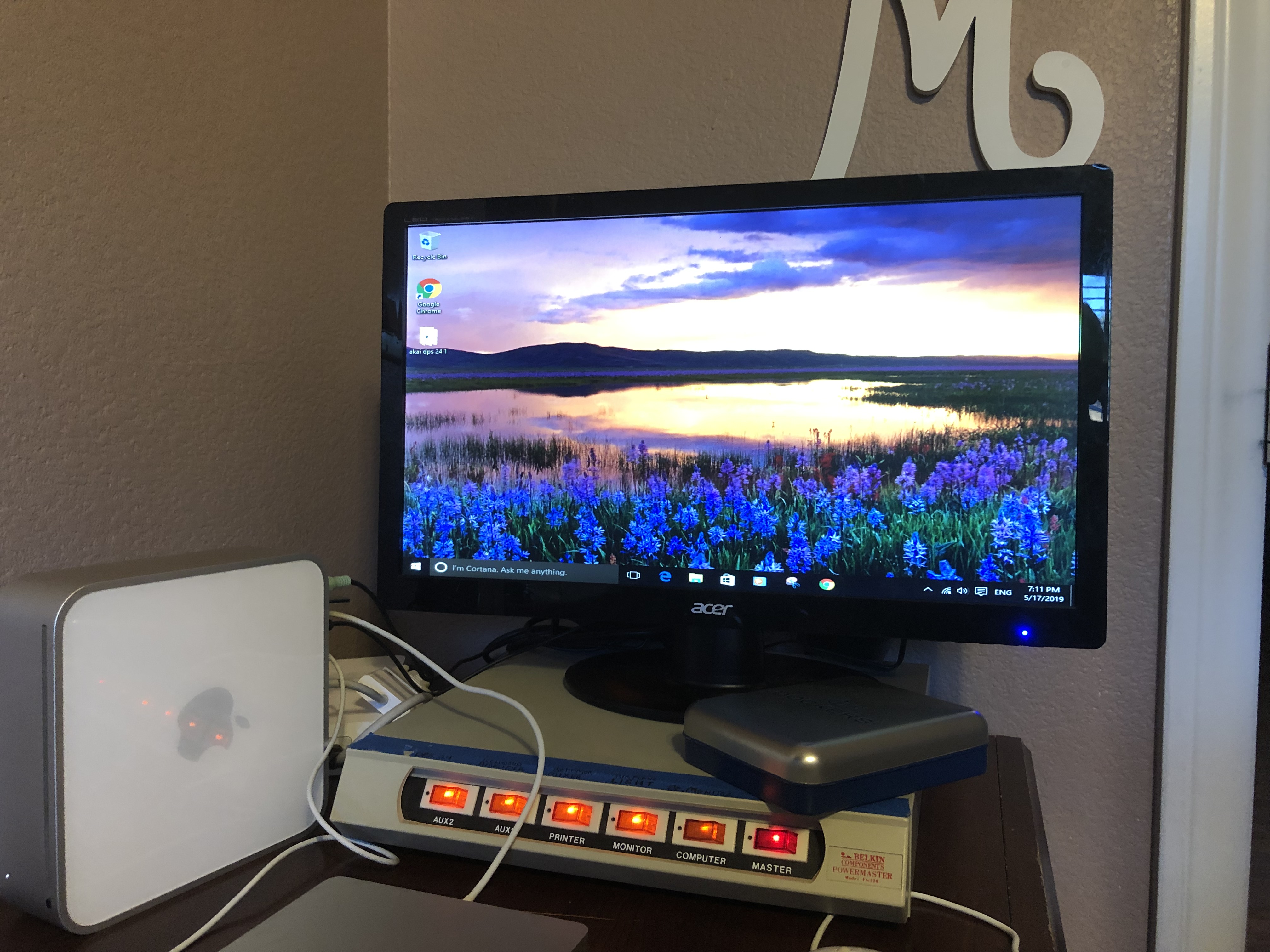

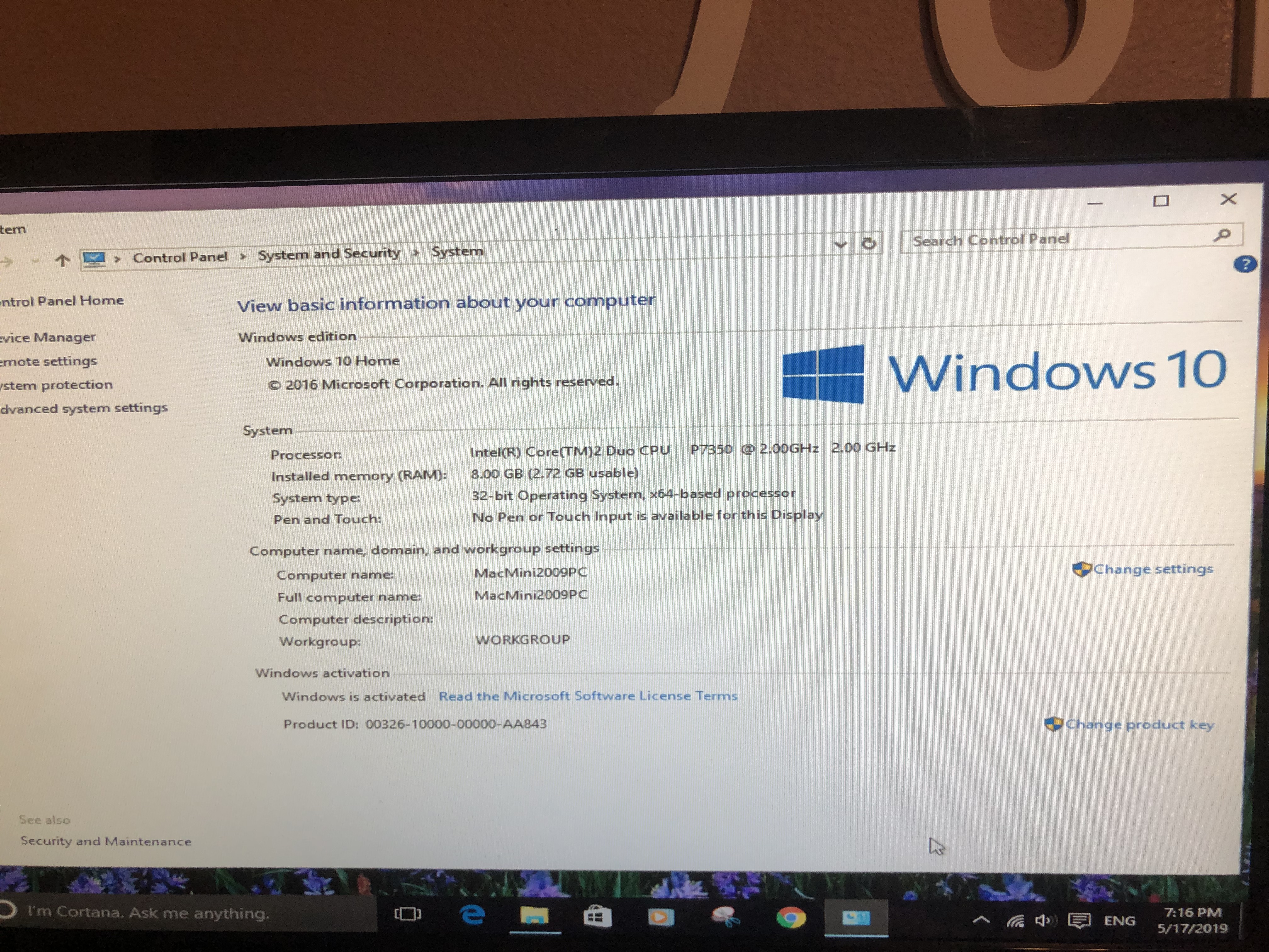

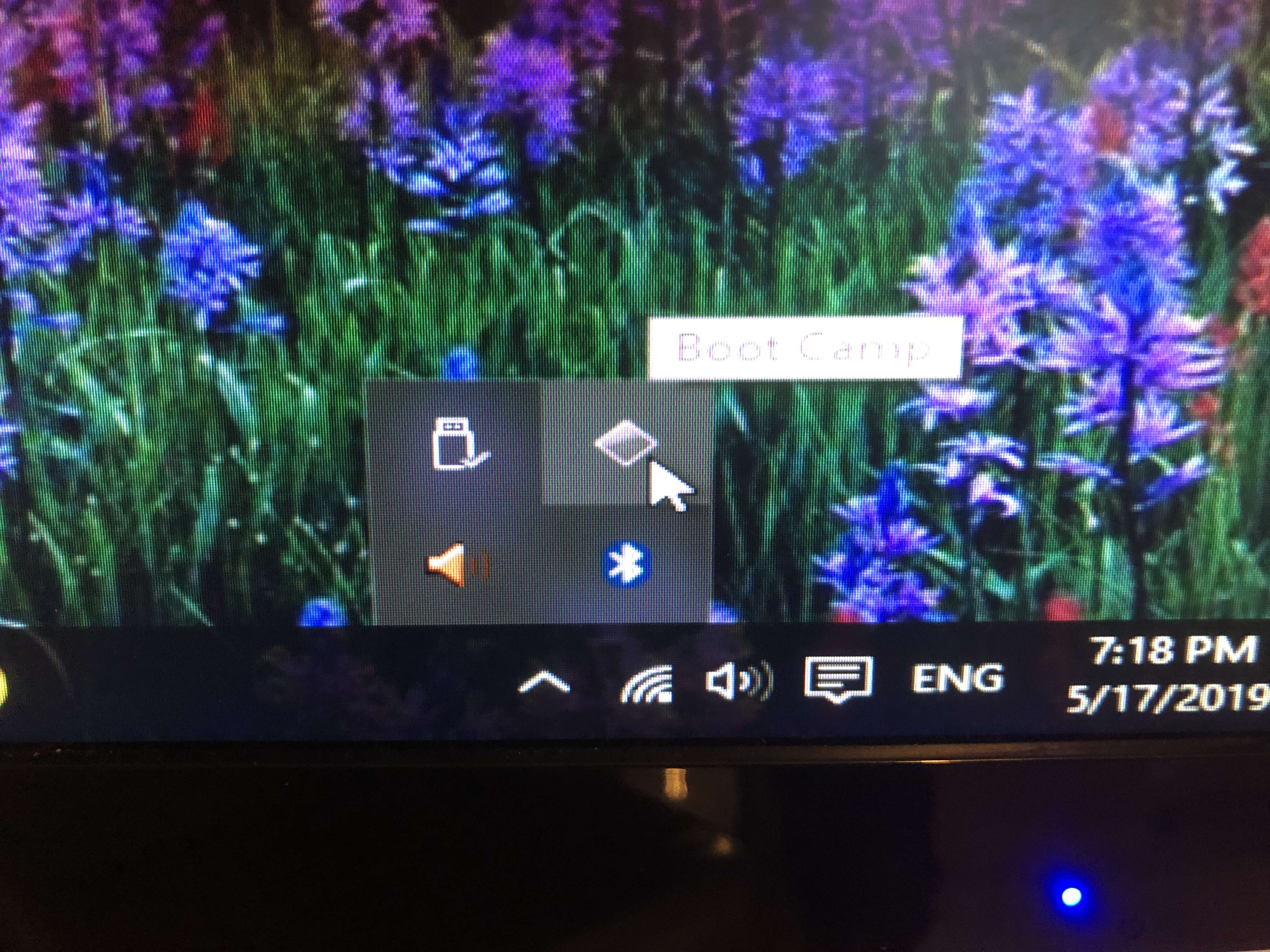

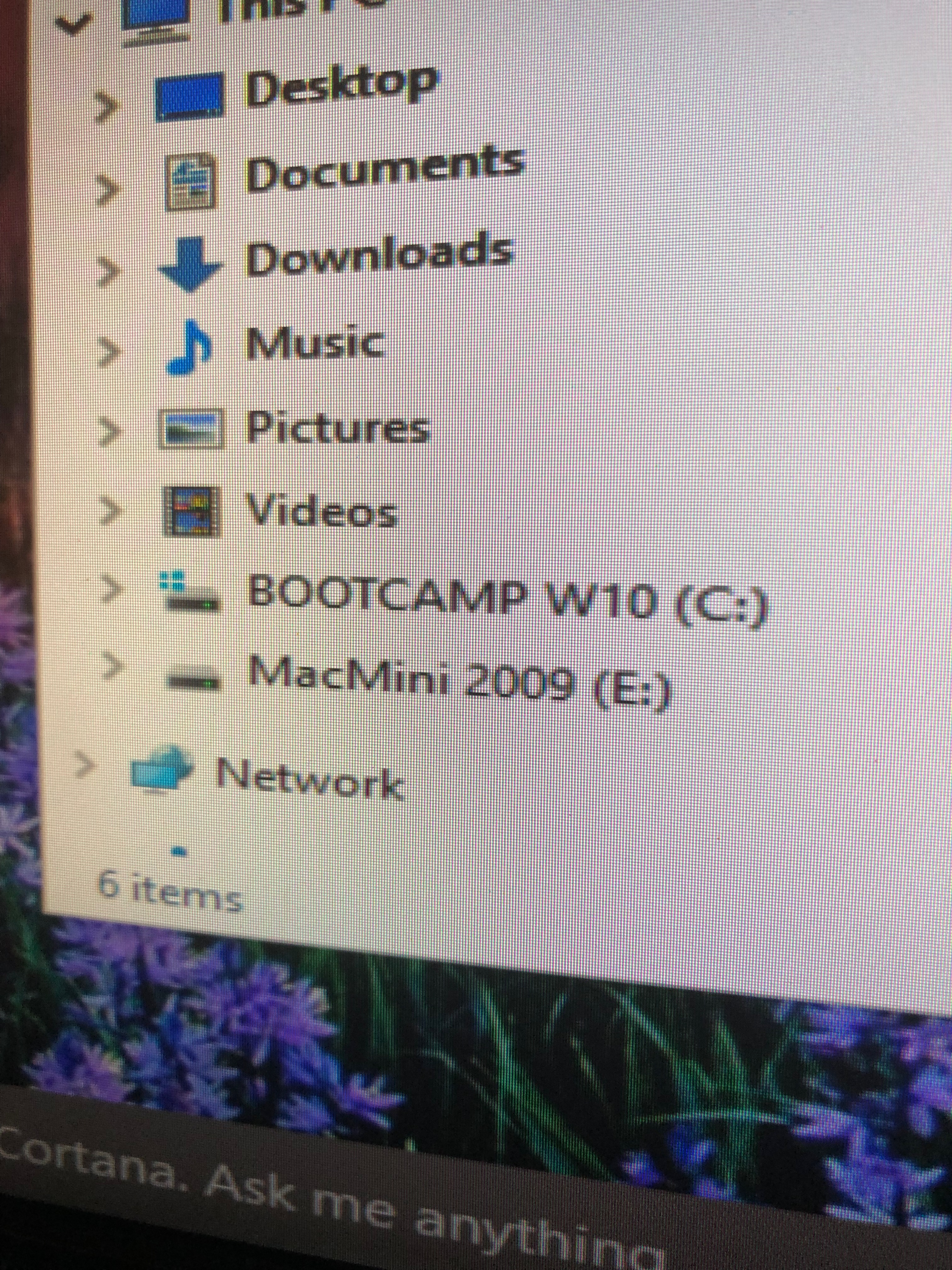

Day 2 and all is running great. Not overheating no crazy fans. I monitor the fan with SystemPal and SMCFan. Both have consistent readings. I do think I will locate some sticky two sided sticky tape in case the sensor comes off.

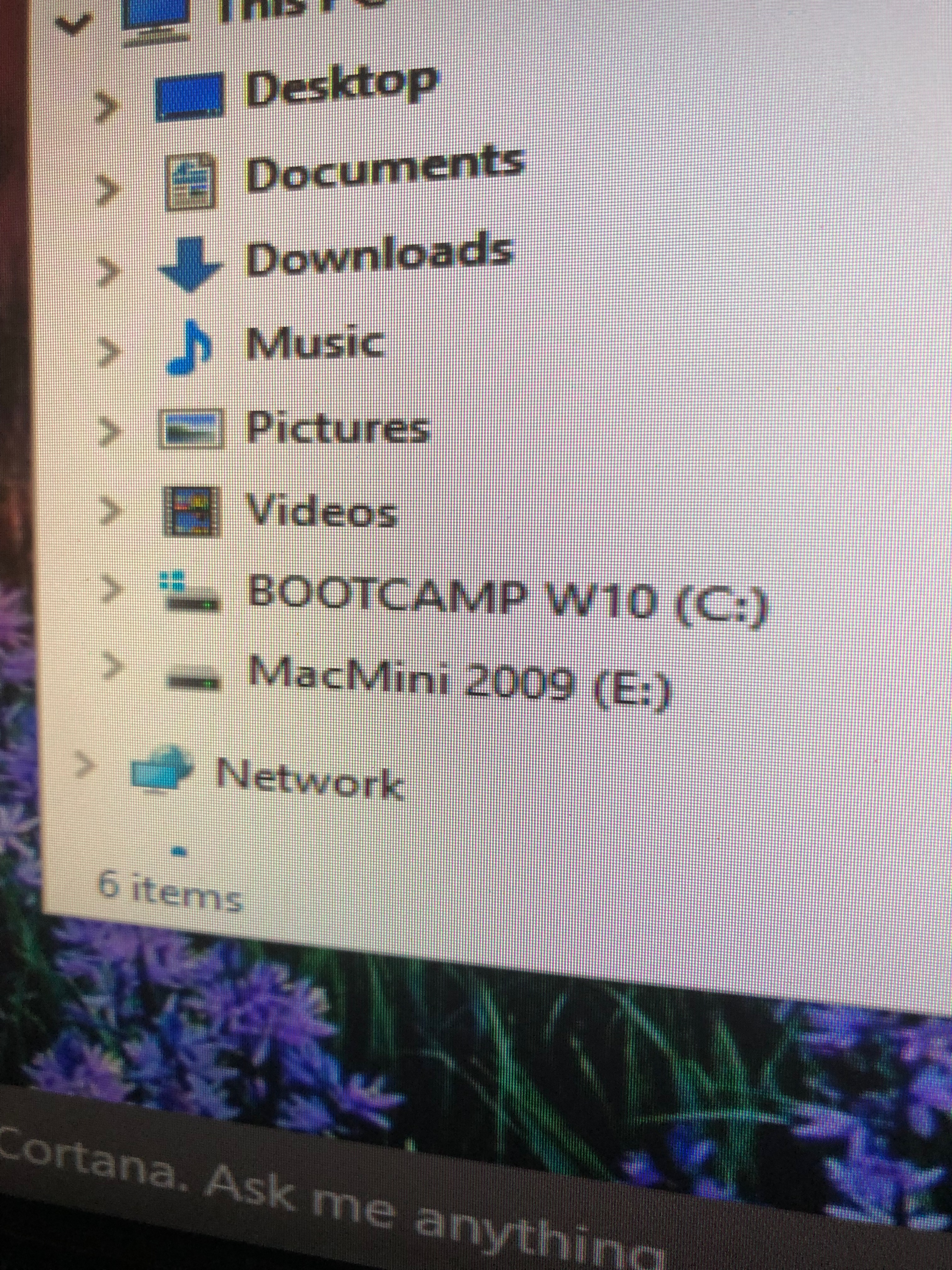

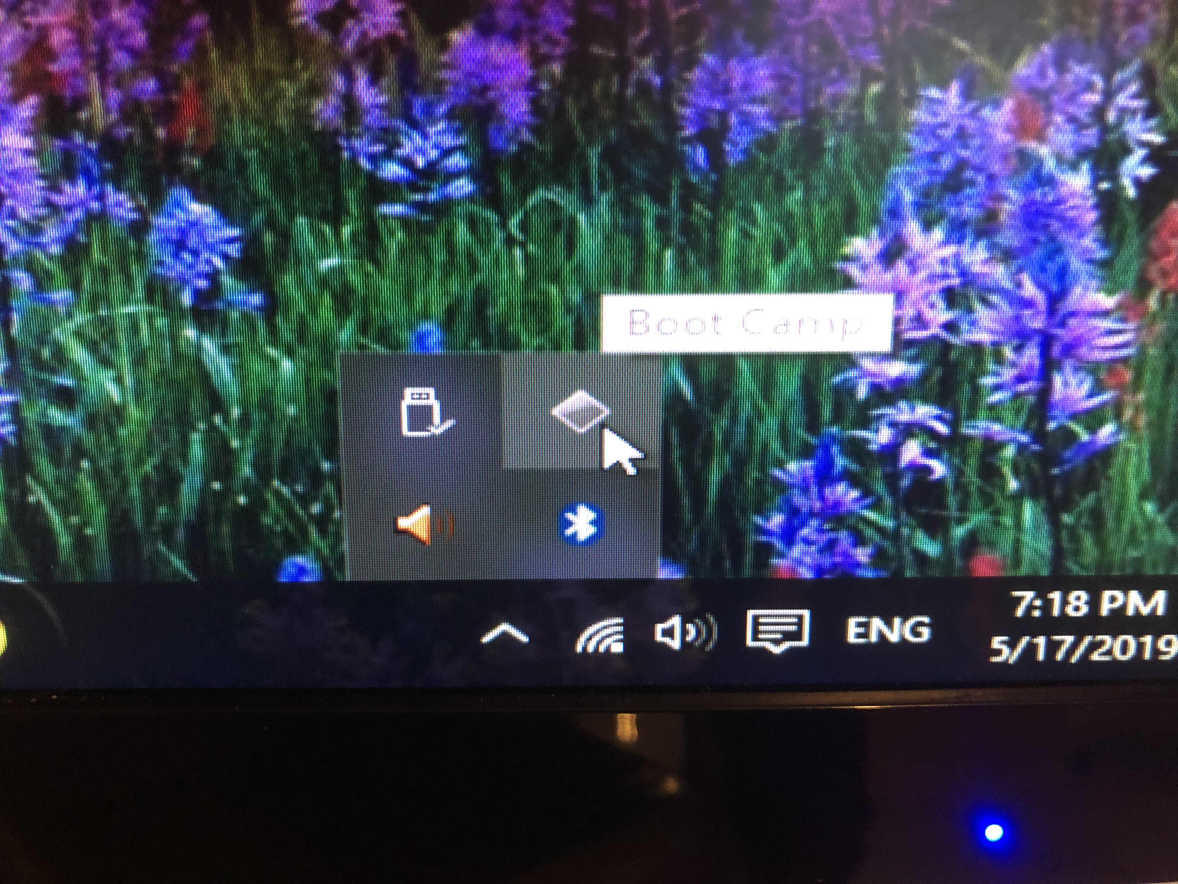

I wanted to add a couple things that I learned:
In case others are wondering about dual boot with this old mini. I know that treek mentioned he had a dual boot.
I have El Capitan loaded as my OSX. I used the BootCamp from El Capitan, and loaded a valid Windows 7 32 bit OS. No issues went smooth....but of course my curiosity got me wondering about Windows 10- 32 bit. I have to stay with 32 bit because of some old programs I will need to run.
I thought even though Apple and Everymac and the Internet, says the maximum Windows OS is 7.....what stops me from upgrading while in Windows 7 . Crazy but it worked and it has an activated windows digital entitlement .
(Back when W10 came out I made two different Windows 10 DVD (32 and 64 bit), and held on to them). So after I tested W7 booting in and out etc....I was in W7 and loaded the W-10 dvd install disk I made in late 2015.
I’ll be darned if it asked “do you wish to upgrade” and I accepted the upgrade, while in W-7.
Then the process started. What I should add is that I sat watching it and every time it reached a point saying “restarting to continue installation”. I just let it restart, and held the “Option” key and it took me to the Windows HD icon and I booted into that. There were five restarts and it took about 90 plus minutes. And then after every reboot it picked up where it left off, as if it were a windows machine restarting. Incredible. And it worked. W-10 works fine, I even still have that grey diamond bootcamp icon, on the task bar, to boot to Mac. All the Bootcamp stuff on the windows side is still there, all the drivers work...etc.
I am sure I must not be the first one that has done that,,,,but prior to doing this I had not read anything
about successfully installing Windows 10 via Windows 7 via El Capitan Bootcamp, on a 2009 MM.
And....it was fun again to mess around with entire process and challenge of opening up that old MM.
I have a free Kingston 480GB SSD and now I am thinking about continuing the fun of playing with my macs. My 2012 MM has a 5 year old EVO SSD, perhaps I should replace that now. Teeny tiny tool stuff indeed, and but I enjoyed the first SSD I put in there, and I still have all the tools. And sadly now....you cannot do any of that stuff anymore with the Mini or the iMac.
