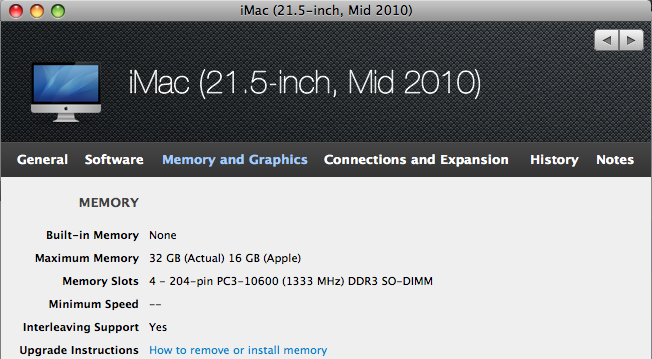

My friend has this model of iMac.. and I have tried to put 2x 8GB sticks into it to replace the 2x 2GB of OEM.. Supposedly, from any and all info I can find, it is capable of recognizing and using 16 GB of RAM, but is there ANY reason that it must be configured as 4x 4GB perhaps, as opposed to the 2x 8GB Sticks I am trying now..?? 😕
** When the RAM is inserted, it powers up and NEVER goes past 'the Start-Up Apple' mid-screen.. and I have tested the RAM, it does work fine in my 2011 MBP, which uses the same spec RAM..

It can go up to 32 GB see below in screenshot.
First things to do is to reset PRAM And SMC.
Hmmmm.. Well OK then.. ** Is that really your Screenshot [not familiar with those graphics] ie. Do you actually have first hand knowledge of this machine (it is a Low End i3 as noted above) running 32GB..?? If so, much appreciated, as then 2x 8GB must be able to function, obviously!!

That shot is from a free program called MacTracker, it has almost all Hardware Apple ever made in it's dataBase.
You can download it here.
Mactracker - Get Info on any Mac

No, it is a database of all apple's stuff ever made, if you choose a powerbook it will have the specs of that one, if it's a MBP it's the specs of that one.
So, the screenshot is of your machine, it's similar to the site you go to, you search for a MBP mid 2008 ... and it will show you just that.
There have been a few instances where MacTracker differs from EveryMac.com, such as this case. After years of using both, I've learned to trust EveryMac.com more, as I've seen MacTracker slow to update and erroneous more often than I've seen errors on EveryMac.com.
Also, be aware you can install more RAM than your model will handle. It will appear in System Profiler, but checking the System Memory tab of Activity Monitor will show you how much RAM is actually being used.
