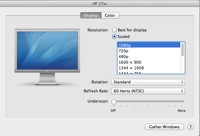

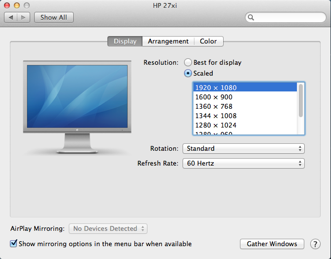

So.. I verified, now that I'm at home, that the HDMI driven screen is the culprit and is maxed out at 1080p while the native display (not the thunderbolt driven screen) has maxed the resolution at 1920x1080.. If I drag a window from the higher res screen over to the lower res, I'm missing the three window buttons in the top-left corner of the window.. I checked for overscan settings in the monitor and found none -- I tried the factory reset but nothing came of that either..

Here's the HDMI driven display -- running at 1080p
Here's the other display driven by DVI running at 1920x1080:
ok.. Solved it.. Apparently there is an overscan feature I missed.. I plugged the HDMI cable on the left display into the primary screen port on the Mac after removing the supplied HDMI->DVI adapter and noticed I had no Finder menu and some of the dock was chopped off on the bottom ..
The setting was under the Image Control->Custom Scaling->Overscan which was set to Auto.. I changed it to 'off' and magically the rest of the screen came back and now the two are all aligned again.. Thx!!!!
