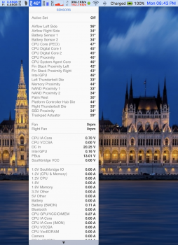

Mine mbp 13" will not kick on at atleat 49 Celsius.

Well, if I look into iStat Menus on my 13" MBP 2016, it shows consistently "0 rpm". If I put some load on the CPU and the temperature rises above 50°C, the fan turns on, starting at about 1200 rpm. It's barely noticeable, but putting my ear on the right side of the keyboard, I can hear it running then. At "0 rpm" I can't hear anything.
So unless you have opened a machine and saw the fan running while the sensors are reporting "0 rpm", I'm skeptical. The 12" MacBook has a passive cooling, why shouldn't a 13" MBP be able to turn off its fan at idle?

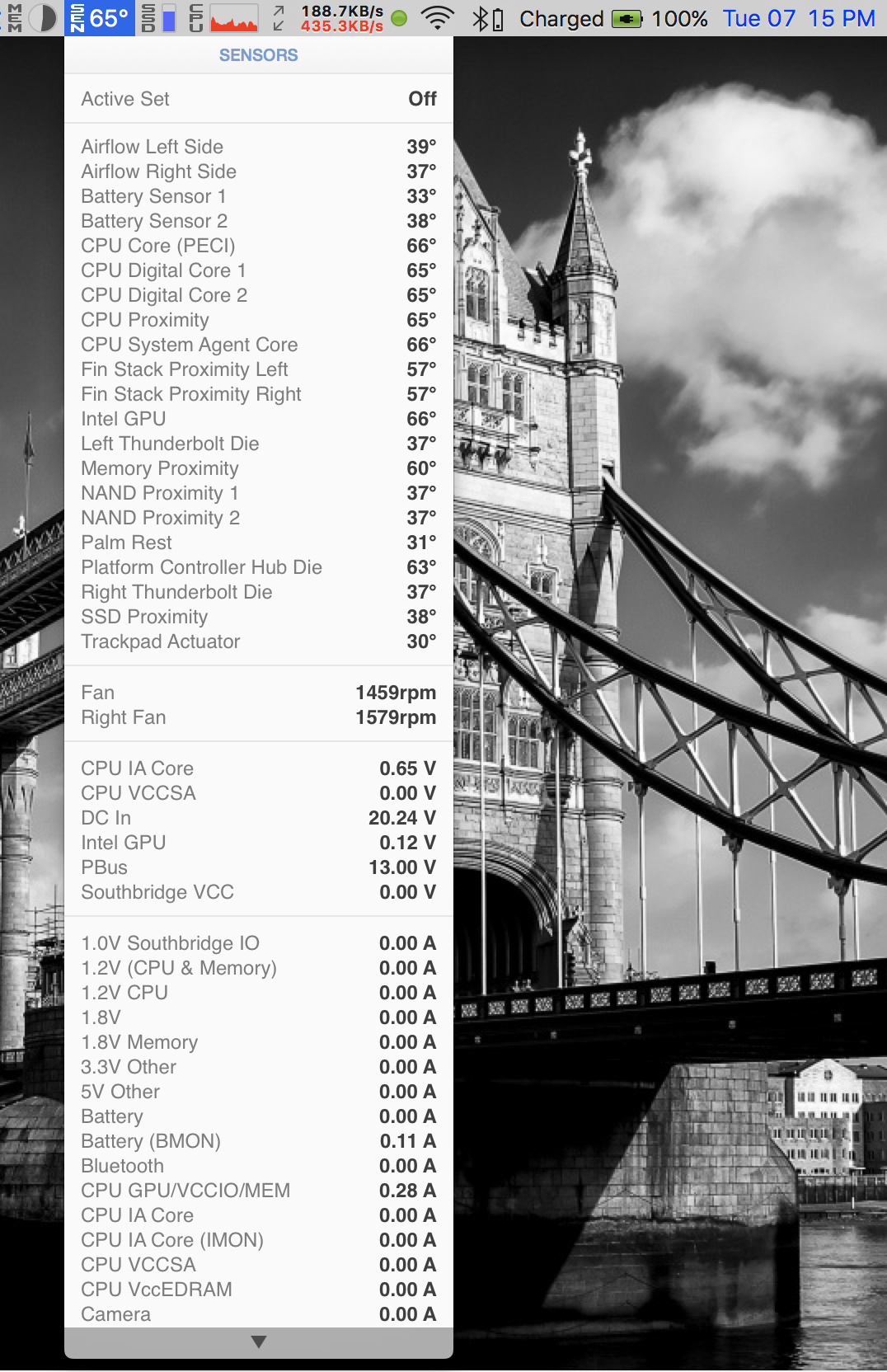

I have a 2017 MacBook Pro 15".
In idle, the fans keep running at about 2000 rpm, I don't hear them. I really need to kick this MacBook Pro on it's ass to increase the fan speed. Even then, they are much less audible than the fans in my previous 2014 MacBook Pro 15".
Never heard the fans blast once on my new 2017 15" MacBook Pro. On my 2012 non-retina, it fired up like a jet engine, even on tasks like light surfing. The difference is night and day.
Mbp 13" Fan is not always running until you need it.
