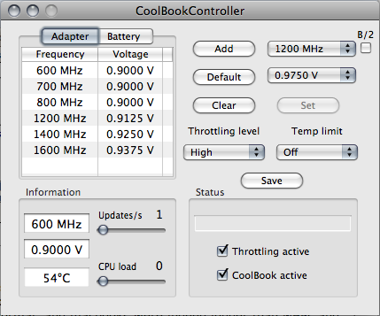

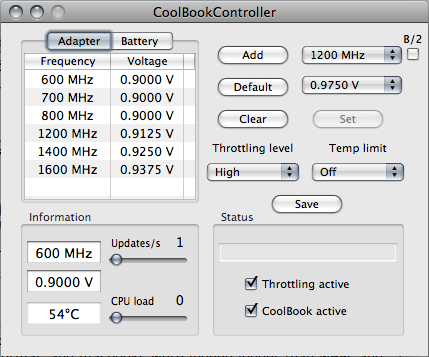

Did you actually try coolbook or is this just a theory of yours?
I think what many reported also was that the MBA got more stable on higher freq, and didn´t downthrottle as much as before the manual voltage settings.
See attachment.

What are your exact CoolBook settings. I would love to be wrong, but it's not like I am lying. In fact, I wish I was 😛
My settings:
attachment.php
