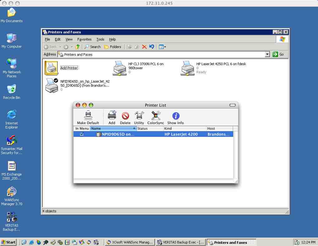

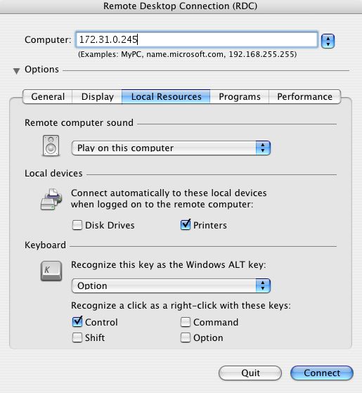

Maybe you didn't understand what I said. On your macs remote desktop software, check off under shared local devices that you want to share your printer (Picture 1). Then on the windows computer that you connect to, it should show up under printers, as shown in Picture 2 where my Printer stuff on OS X is over top of the Remote Desktop Printers area. Then all you need to do is print.
