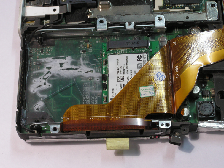

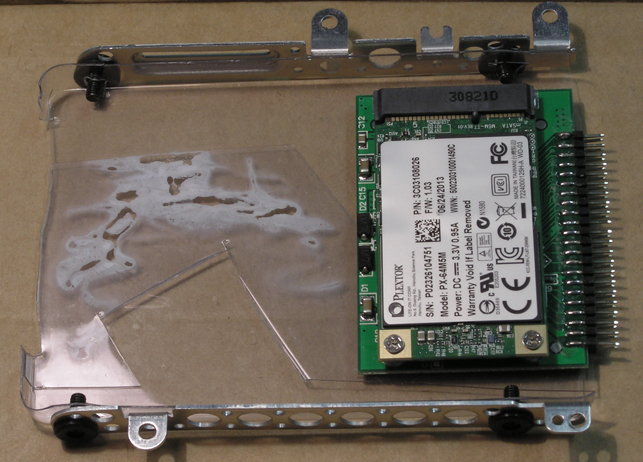

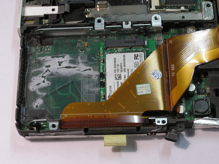

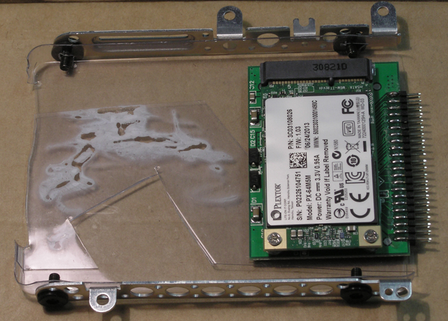

When I was deciding what to replace my dead HDD in my iBook G3 with. I read reviews and found that buying IDE SSDs was like a gamble. So I went with PLEXTOR PX-64M5M SSD and an IDE to mSATA adapter.
It's much snappier. Boot time, applications launching are also way faster than before, even though it is merely ATA-66. I think random read/write speed is more important than sequential speed in my use. I haven't found any compatibility issue.

These adapters fit in the form factor of a 2.5" Pismo drive bay?
I believe the converter bay is the same size of standard 2.5" HDD.
Well, the size of the mSATA-IDE adapter plus the SSD is less than half of a 2.5" HDD.
When I bought mine, there was no reasonably priced converter bay available yet.
So I just bought the mSATA-IDE adapter board and place it on my simple DIY plastic tray.
You can adjust the size as needed. I'm not afraid it would dangle inside mine because the cable holds it securely.
I don't know how it is inside the Pismo but I think you can DIY something for it.
