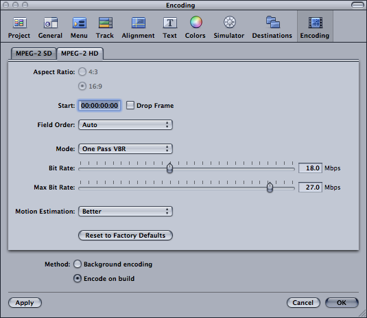

My video is currently 9.1 Gigs as DSP tells me.
I'm using these compression settings:

first off, NO do not ever use Aiff...this just wastes space on your DVD. Use the Dolby 2.0 encoding.
now in your first post, you attached an image showing the encoding specs for a high-definition DVD (red laser, not HD-DVD or blu-Ray). Now it sounds like you are encoding for standard-def. Assuming you are burning to a dual-layer DVD (since you are trying to get 3.5hrs in good quality), then just use the 2pass VBR 120minute preset in compressor.
Thanks for your help, I don't think I was actually using those HD settings, I must just have not clicked over to the other tab to show the settings I was using.
