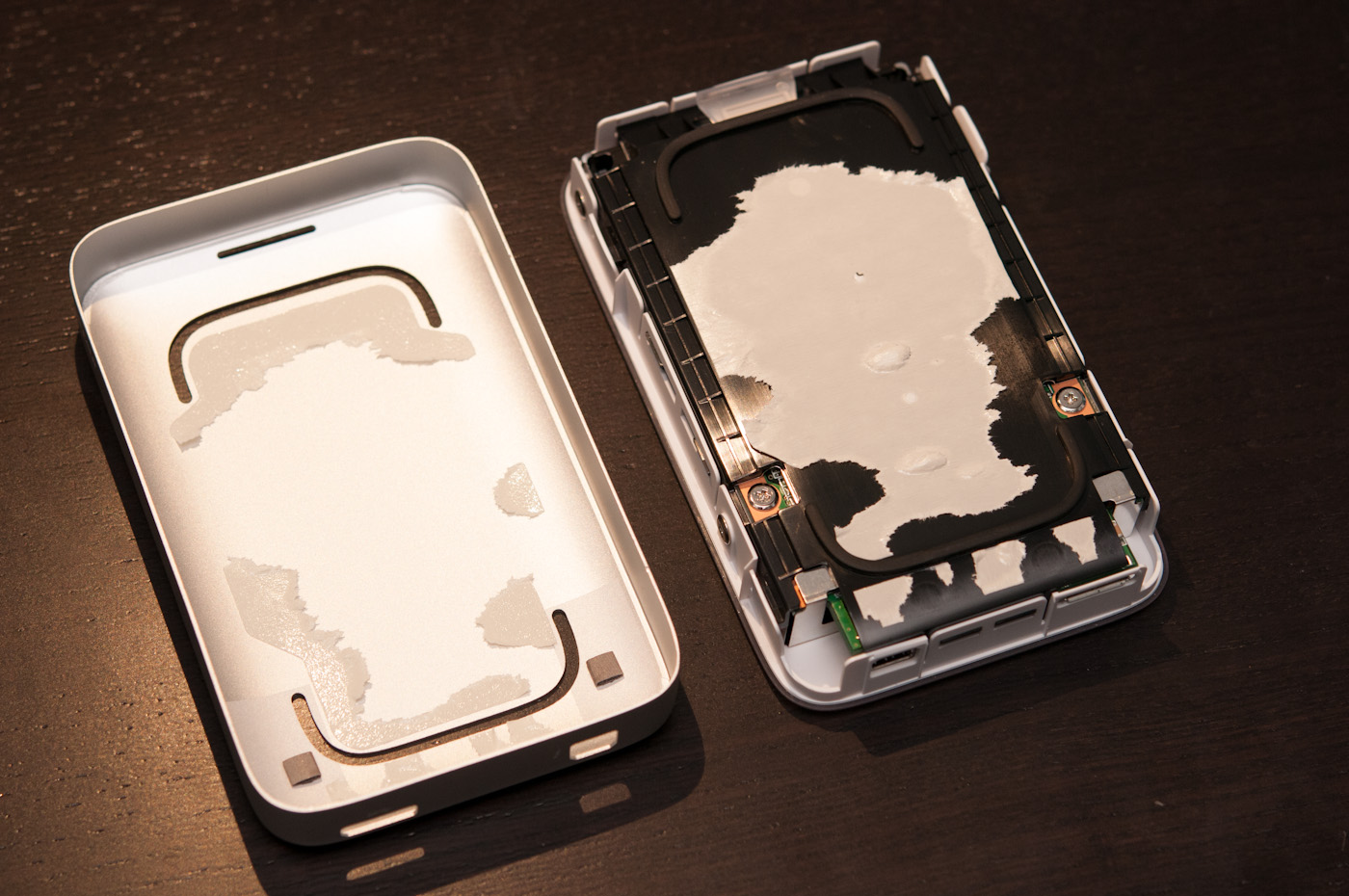

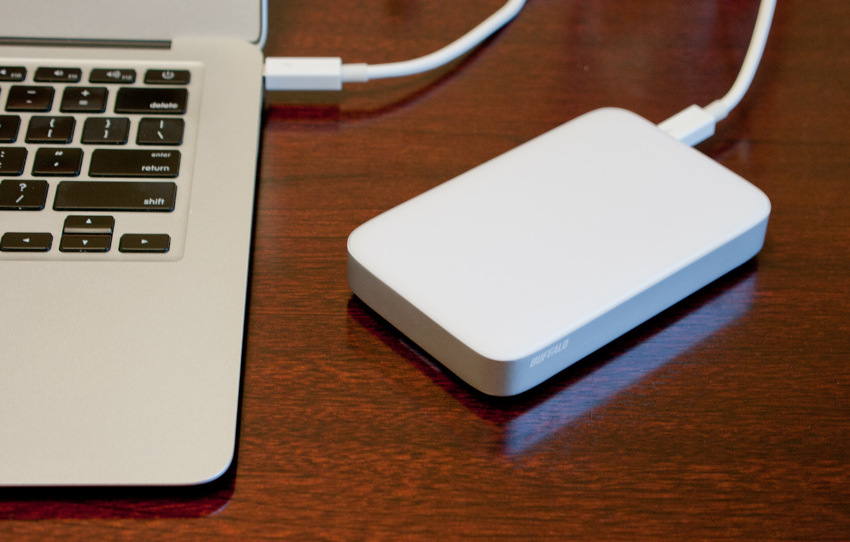

No pictures of mine, but here's some that I found using Google:
Picture of one apart, with bottom section on left, drive and top on right. The drive is screwed into the top part, and sticky tape holds the bottom of the drive to the case bottom. Heating the underside of the enclosure makes taking it apart easy.
Sitting next to a MBP, very much looking like, IMO, that it could be an Apple product. It also has a USB 3.0 port, but I use the TB connection.
