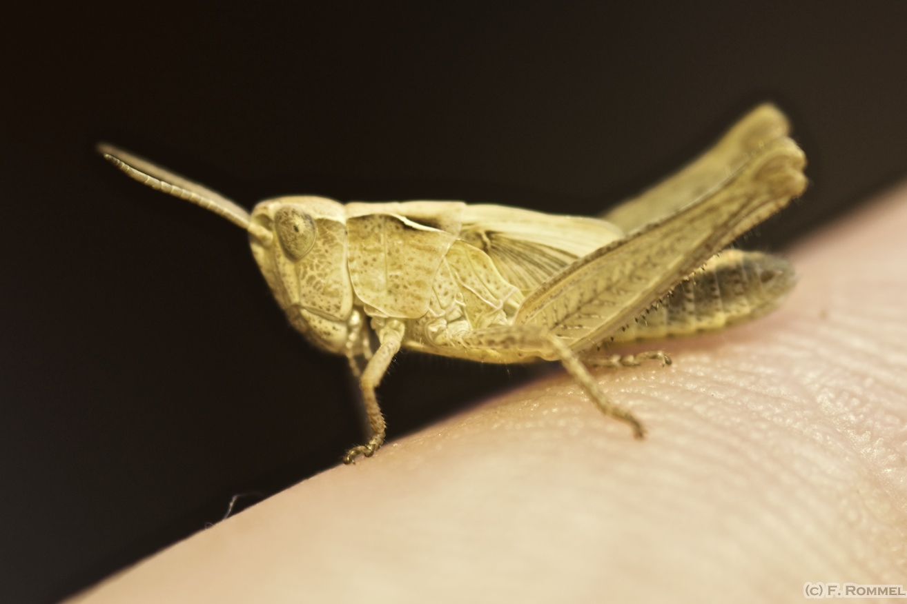

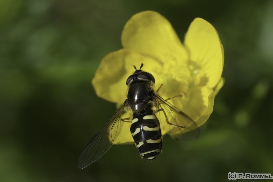

I am including a few shots from my Macro shots with the Sigma.While they are not GREAT, they show what is possible. The Wasp or fly, was shot handheld, the grasshopper is about 6mm long in reality as you can see by the grooves of my finger in the shot.
Once you have a lens (even a shorter Sigma 70mm will do for the beginning), start experimenting and practicing. You will work with VERY thin depth of field so a lot of times your subject will get out of focus fast.
