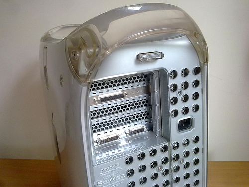

2. Two of the expansions slots are open (image below) and it seems like it could be a dust problem. Are these open to keep the machine cooler? Should I close these off?
Stock "slot covers" for MDD are looking like below:
Holes are to exhaust heat from the case. If you want to preserve original cooling design, you should have to use such "covers", not the ones you have now. Or just leave these 2 open.
If all the expansion slots were filled, those would be blocked anyway, wouldn't they? I don't think those can be a dedicated, necessary part of the cooling if they are designed to be blocked when the expansion slots are used. Am I missing something? That machine should have 4 PCI slots and the AGP slot, if I remember correctly, hence the 5 expansion slots. 😕

The blanking plate will allow dust in if you don't fill it, but it won't disrupt airflow enough to make any sort of difference to the airflow of the machine what so ever.
Yep, if all slots will be occupied, heat inside the case will increase. But I still think that blanks have "chease greater look" not without a purpose (other than good looking OFC). Cool air is pushed from the front (holes at the bottom of case, just over front leg) and exhausted at back. With such airflow there's no possibility for dust to get inside by PCI slot blanks. Anyone who has disassembled MDD should notice how air is pushed through the casing.
If you'll block all PCI slots with cards (which are generating their own heat too) it will also affect CPU temp and its fan will be running a little faster (and noisier).
MDDs were first Macs equipped with CPU thermal sensor (AFAIK) and first ones with OS controlled fans (by kext). If CPU temp increases, CPU fan speeds up. But TBH, all MDD heat management wasn't that perfect, especially for DP versions. SP are running cool and quiet (relatively OFC).
