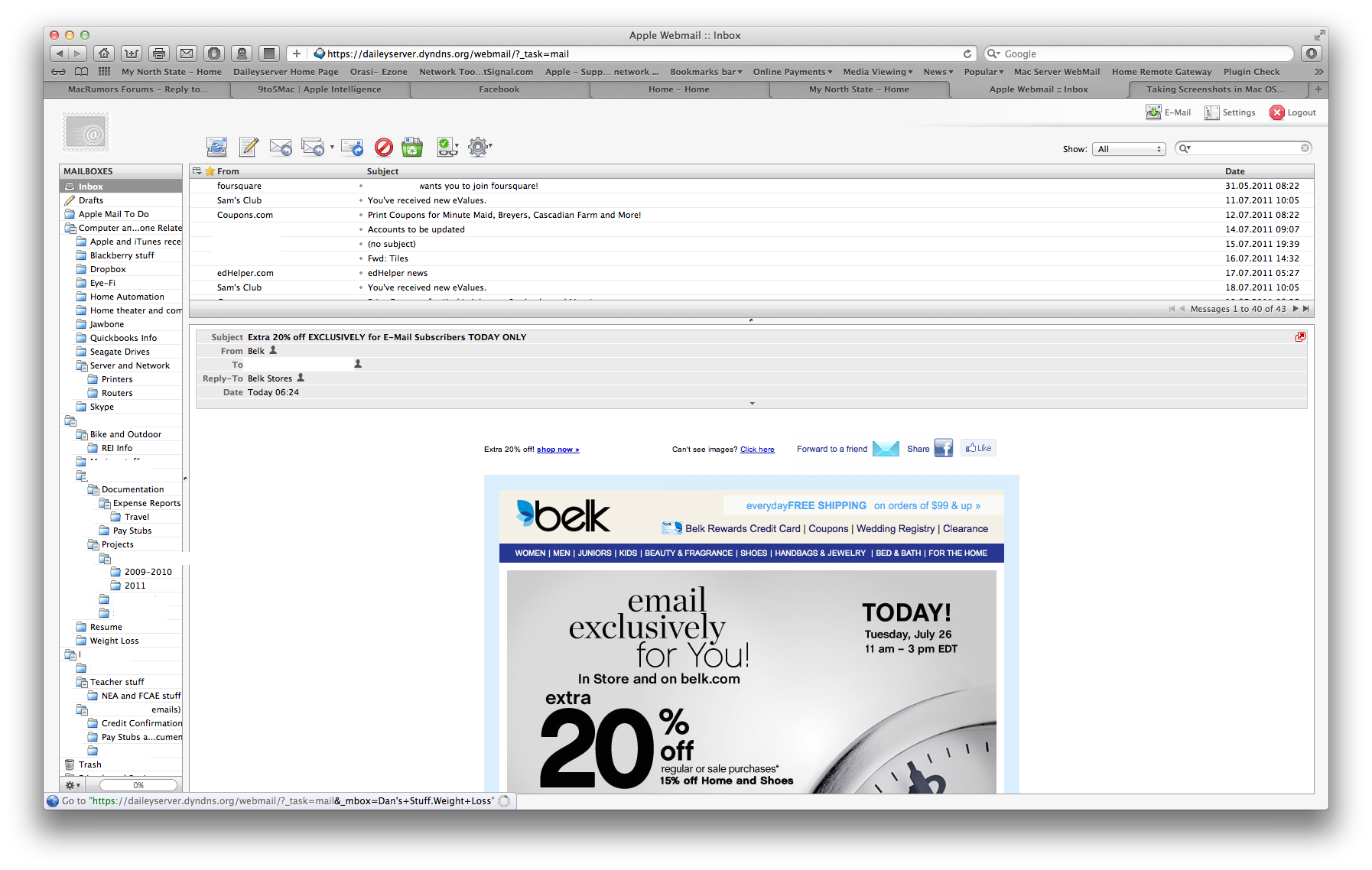

Finally, has anyone seen screenshots of the webmail in this version? I'd love a link or a review of this part of lion.

I have a Mac Mini Server from 2009 that I just upgraded to Lion the day after release, so I may be able to answer some of the questions.
As far as RAID goes, you would need to go into the Disk Utility upon start up and build your RAID Array. I tried this at first and realized the only thing that I gained was a little redundancy and maybe a slight speed boost (remember mine is a 2009 so it came with 5400RPM drives, so not exactly a speed demon and RAID isn't a backup option, it is more for data protection). For what I use, I liked it better to delete the RAID and run the OS off of drive 1 and store everything data related on Drive 2. This worked great for me when Drive 1 died, as I lost nothing, just replaced the drive and reloaded the OS and pointed to the folders and data.
I didn't try cloning it, but it should work. You could back up to an external and then start from there. I would recommend AppleCare as it gets you phone support for the 3 years (and it is cheaper on the Mini than the MBPs) which is initially good for only 90 days of phone support.
I haven't checked out how the recovery is on Lion yet (there was none on Snow Kitty other than reloading from the disks).
I can tell you from first hand that the techs on the phone are learning just like we are. I was on a call for a few hours with no resolution, and then things just started working for no explainable reason. The Webmail is so much better than the older version. I will try and attach a screen shot as requested.
