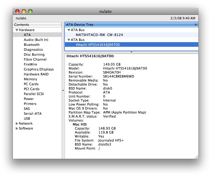

I just upgraded my late 2004 iBook's hard drive last night. It took about 1.0 to 1.5 hours for the disassembly and reassembly. The process was pretty straight forward and I didn't have any problems.
I downloaded the iFixit guide for replacing the hard drive and printed it. The instructions were easy to follow and the screw guide was very helpful. I stuck some double-sided tape to the screw guide to keep all the little screws securely in place.
The tools they show you'll need are in fact required. You'll also probably want a small slotted screwdriver for a little extra help popping out the feet and the metal rings under the feet.
I used a HITACHI Travelstar 160GB 5400 RPM hard drive (from Newegg). I also grabbed a Macally external firewire enclosure to stick my old hard drive into (also from Newegg).
160GB is waaay better than 30GB. 🙂
