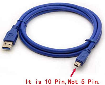

USB-miniB for USB-1/2 - this was common a decade ago, or so, but is rarely used today. There is no USB-3.x variant.
I've never seen anything use them, but I've seen some mini B USB 3.0 cables.

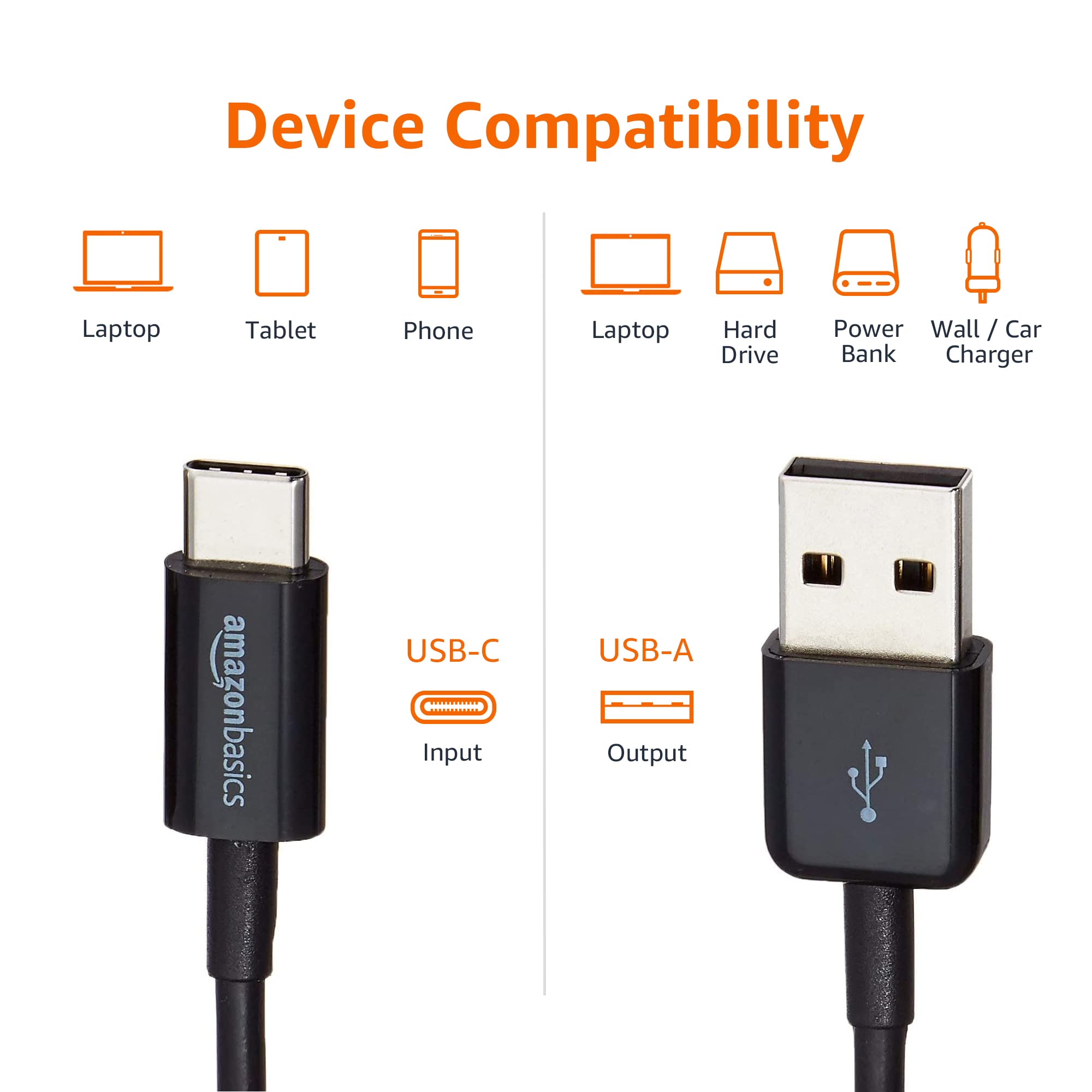

Either an adapter like this:
(you'll want 2 or 3 of these)
or
A cable like this:
(numerous choices available)
