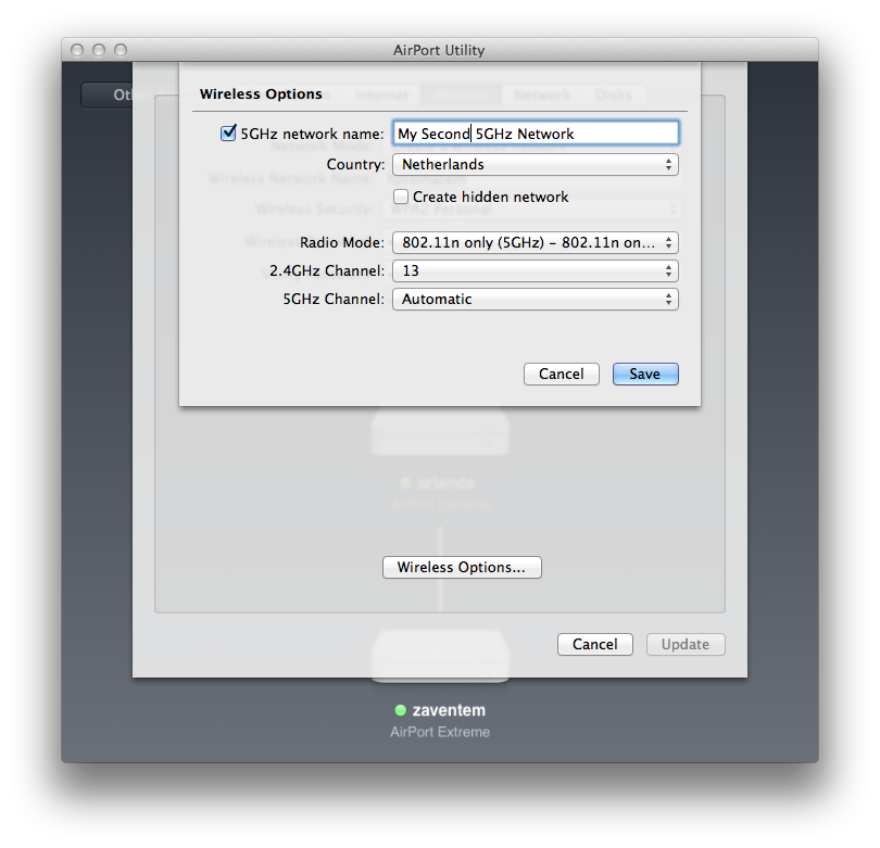

3. Airport extreme doesn't automatically provide 2 different frequencies unless I enable it, right? (Just want to make sure)

The Extreme does work with dual band by default. What you might be seeing there is creating separate frequency networks, and that is not on by default.
Did you want to say, that by default both 2.4GHz and 5GHz wireless networks share the same name (aka SSID)? You can manually enable the feature to assign a different name (SSID) to the 5GHz network, if you will.
