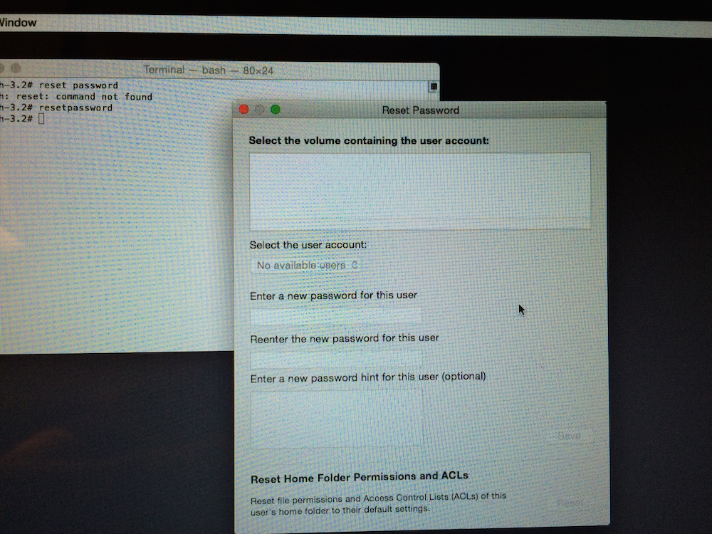

    My Mac's are on Yosemite and encrypted with FileVault so I figured I'd just try what the video said. It turns out that it cannot be done. When I get to the part to select the volume for the main disk, it is grayed out and there is nothing to choose, therefore preventing the password keychain from being reset.
