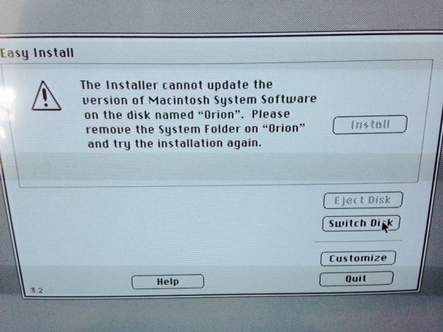

Last night I tried to erase the hard drive on the Mac II by inserting the disc before starting it up and this is what came up (Orion is my hard drive). I'm guessing I have to erase the hard drive beforehand because you cannot boot off an install floppy disc...is that correct? If so, how would I go about erasing the hard drive?
Also, after erasing the existing hard drive, can I do a clean install using an updated version (e.g. 8.6 instead of 8.0)? I thought updated versions were improvements on the original OS, and therefore doesn't install the entire operating system again. If I purchased a retail CD online, would I be able to boot off it as per bunnspecial's instructions if it is a different OS other than what is currently running on the computer? (i.e. Could I use 8.0 if PowerPC 8100/100 is running 9.0?)

From your picture it would appear that you are attempting to upgrade the version on the hard drive instead of carrying out a completely fresh installation.
Boot off the disks as per the instructions linked to and erase (or better still repartition) the target drive Orion before selecting your installation type. Because your drive is wiped clean, the installation routine should automatically select a fresh installation.
As for your discs, MacOS was sold as complete universal installers, upgrade installers or machine specific installers. Your discs should tell you which you have. As with Windows, you cannot use an upgrade installer to carry out a full installation from scratch. You can usually only use machine specific releases on the computers they were sold with.
You can use any full version installer subject to two limitations. The version must not be earlier than that which came with your machine. The website Everymac.com will tell you exactly which version of MacOS came with your specific machine. The other limitation is that your machine's hardware will only support a number of versions - typically limited by the architecture of the CPU. For example, the Powerbook I am typing on was released with MacOS 9.0.4. I cannot install any version of MacOS earlier than that on it. It will also, by virtue of its G3 cpu, not boot any version of OSX later than 10.4.11.
