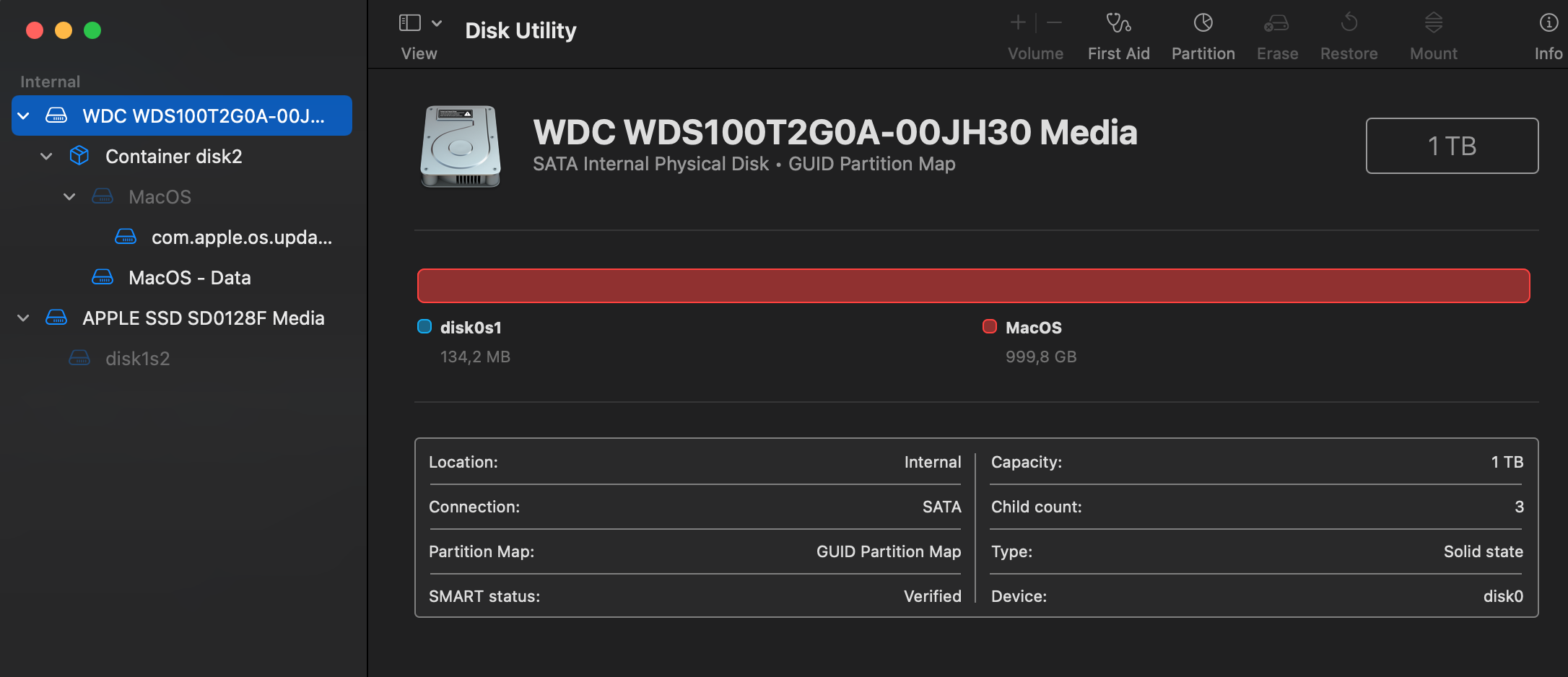

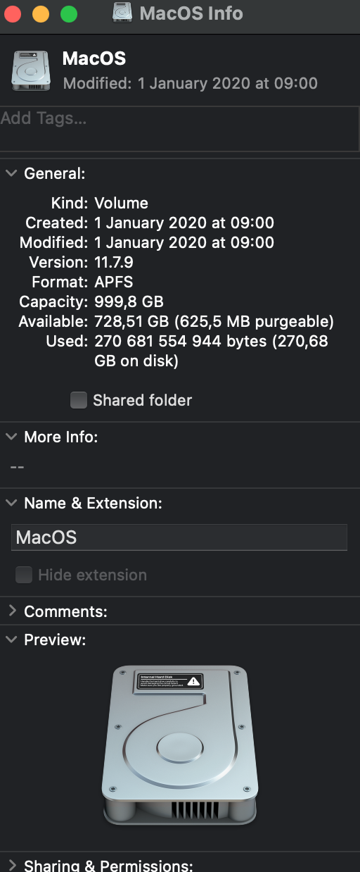

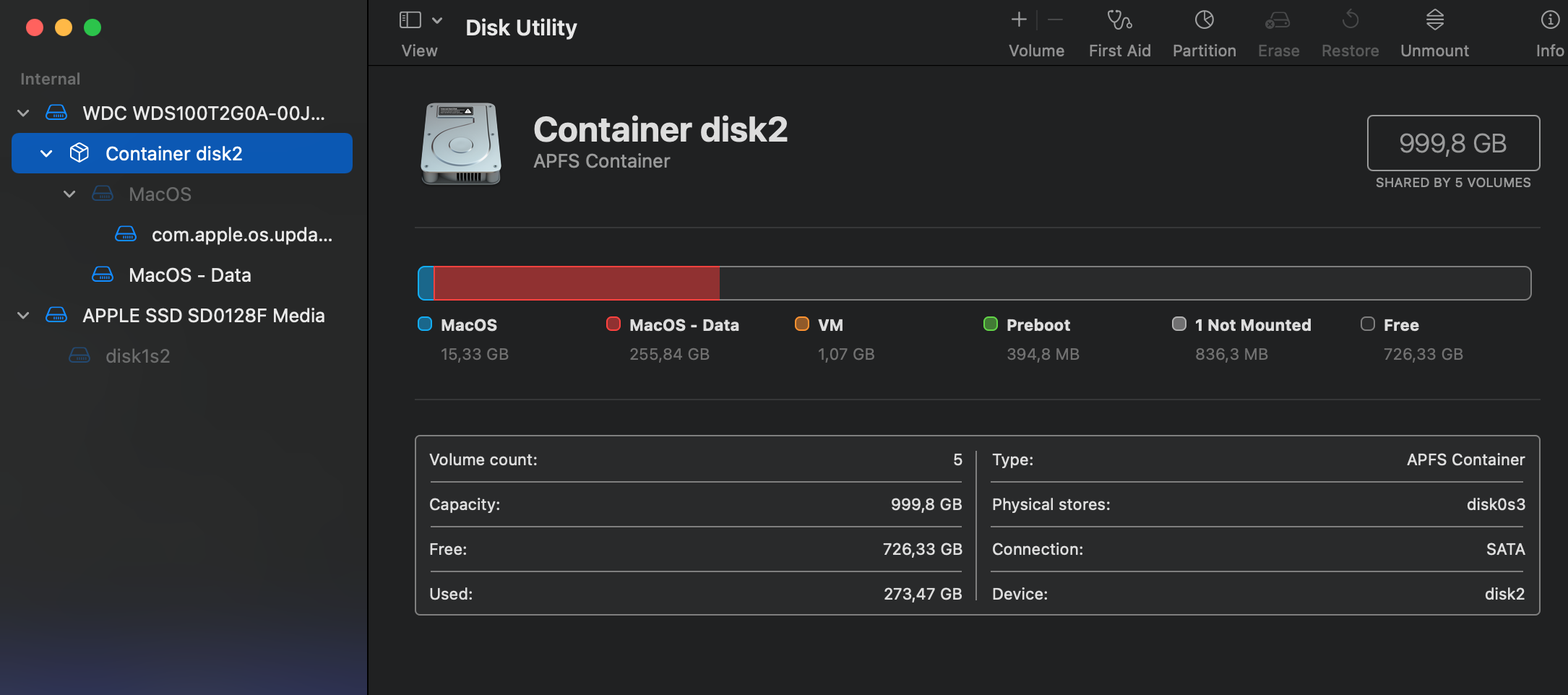

Here's a snapshot of the drive info:
MacOS drive info:

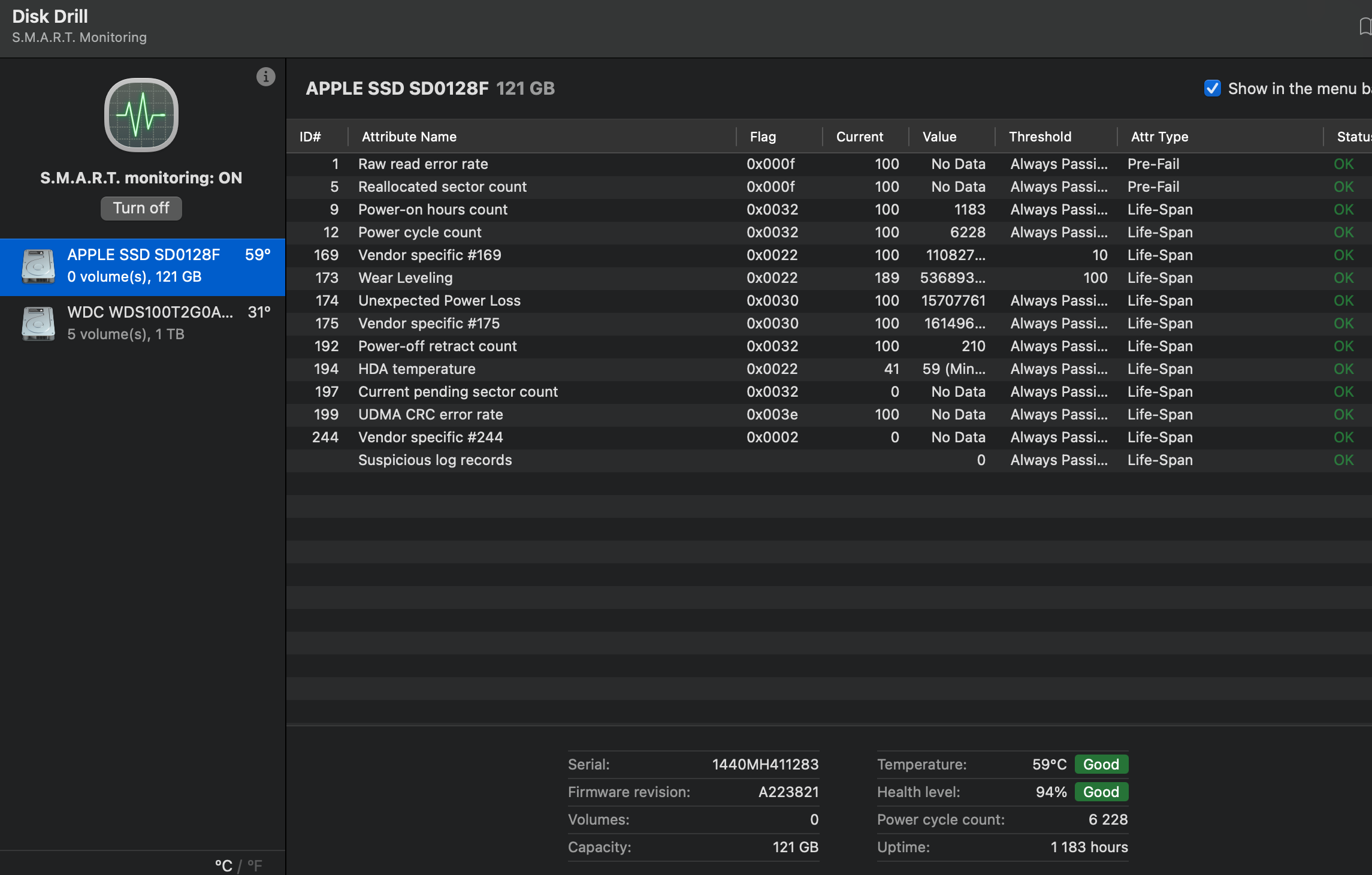

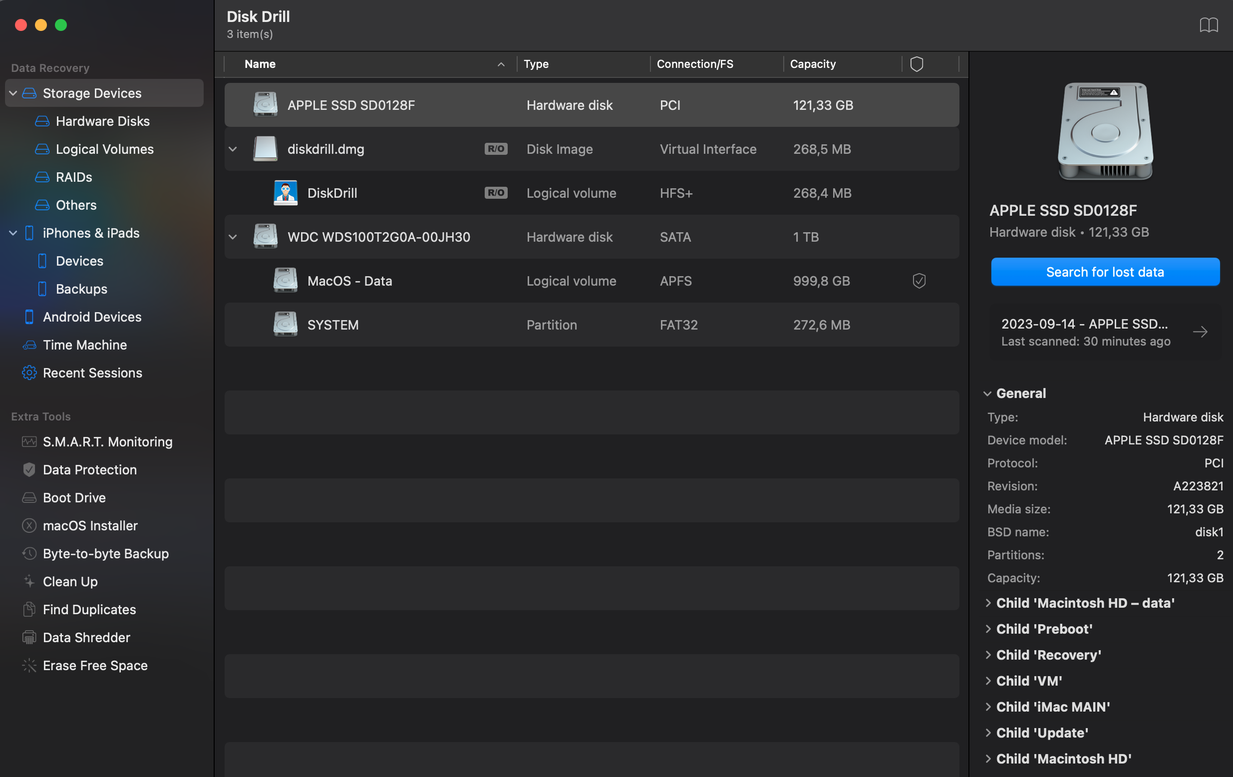

DiskDrill results:
S.M.A.R.T. scan results:
