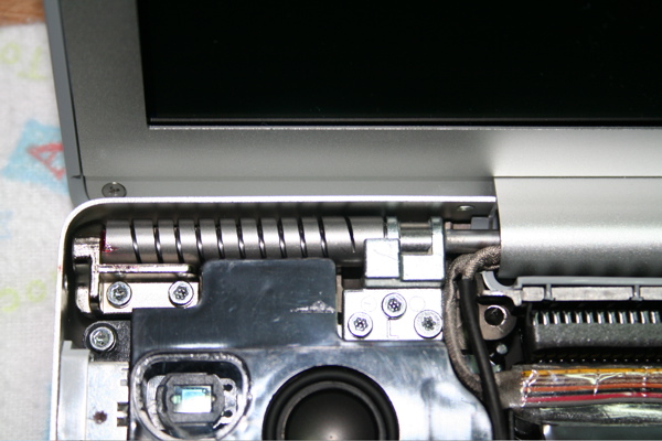

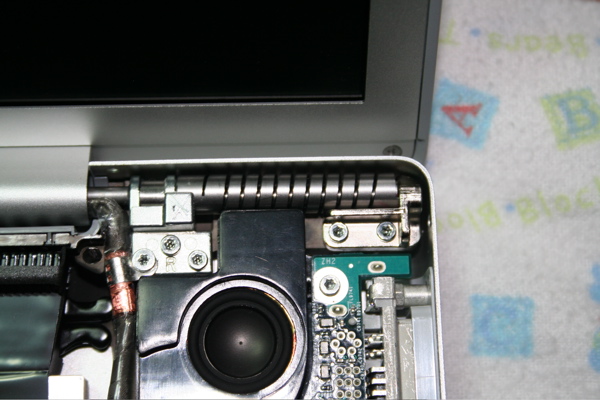

Okay - I fixed it myself!
it wasn't exactly simple, but not too hard either. Now I can have the notebook at a 90 degree angle from the desk, and the LCD will stay open. What I did was this;
1) I followed the iFixIt.com guide to removing the upper case.
2) Removed the 4 screws from each side of the tension springs. (two screws on each side of the hing - closest to the edge of the notebook.
3) support the display and remove the 6 remaining screws supporting the display. (3 on each side, 1 long one and 2 shorter ones)
4) Once the display is free, I used a small torch to heat the spring and twisted the end of the spring AWAY from the screen. You will need to heat it up enough to bend the steel. You should get it final resting posisition about 10 ~ 15 degrees.
5) Put it back together.
PLEASE PLEASE PLEASE
If you try this - PLEASE be carefull!!!! If you hold the torch at the wrong angle YOU WILL DAMAGE THE LCD!!!
Side note - Interesting fact - The 17" MacBook Pro has 4 speakers.

Wow! You Are One Courageous Customer!

Wish you had taken a picture of both speakers on each side while it was open. So the tweeters are below the woofers off picture?
I doubt anyone else here will follow your instructions. Who else here even has a blow torch in their home? 😕
I am shocked at the Apple Store employees' attitudes. Unbelieveable! 😱

I did 🙂
It's not the clearest pic, but it works.
