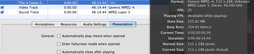

Need more info:
1. What's the actual codec of the AVI. AVI is a container format.
2. What is the resolution of the AVIs are they HD?
3. Are you saying you can import the AVIs fine, but if you edit them they become unrendered again?

I have attached a picture of all the information that I can find on the clip.
The reason I want to find an alternative is that the current process is time intensive as it took a couple of hours to be there to render the clips as the program kept on crashing and I would keep getting the "error: out of memory".
It also takes up a lot of space on my hard drive as rendering only 13 minutes of clip takes up 8.9GB on my hard drive.
