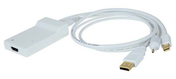

Here is another option Engadget just posted:
http://www.engadget.com/2009/10/05/kanex-mini-displayport-adapter-will-bring-your-mac-mini-to-hdmi/
Looks like that will send your sound over HDMI as well.
