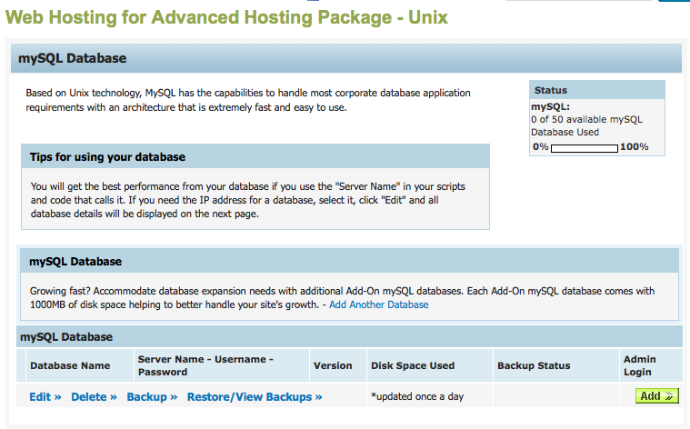

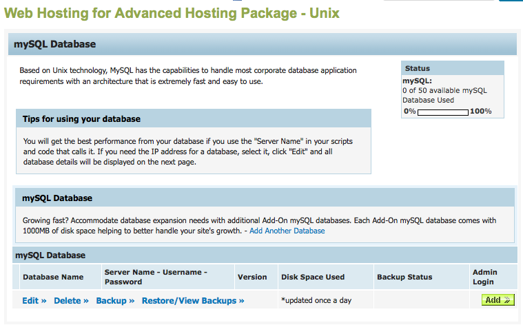

There is no option to import from the start. I have to add a new database, and then later upload the file. I'm attaching a screenshot to show you the options I am seeing.
Ah, so it's not quite phpMyAdmin. I see two options. You can see if you're able to SSH into your account to access MySQL more directly and use the link I provided earlier, though it's quite possible the host has limited the commands you can use through the command line.
