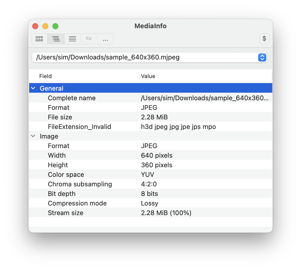

What exact camera do you use? Can you use MediaInfo (free in the Mac App Store) to open one of the MP4 files and attach the report from TREE VIEW (CMD+2) in your reply?

I can't find anything, if the camera uses H264 or M-JPEG as encoding mechanism, thus cannot help further.
Either use Media Info and its Tree View option to share the technical details of one of those MP4 files it produces or better yet, share a small sample file you can easily share. You could just record a blank wall for a second or three and that MP4 will probably be easily shareable via WeTransfer or anything else, as it will be less than 10 MB in size.

PPS: I just found an M-JPEG sample file, but it had an .mjpg file extension instead of MP4.

You could also just do a screenshot of the Media Info window via CMD+SHIFT+4 > SPACEBAR and click with the mouse pointer onto the window.
