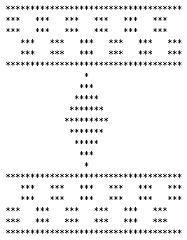

I need to have the program printout the attached image.
I already have the code for all of it but the diamond in the center as follows:

The first question would be if there is any way to reduce and simplify that code, but using nothing more advanced than "for" loops.
Secondly, I am stuck on the diamond part. Using a for loop, I get stuck with the following code:

Any help is appreciated, and thanks in advance.

For the diamond, I worked it out using a line equation in slope/intercept form (y = mx - b, where y works out to be the number of stars to print each line, and x is the iteration number). I ended up with very tight code. Use a piece of graph paper to work it out. I started out by observing the following characteristics:
1) there are 36 columns, and the the diamond starts in the middle.
2) for each line printed, the number of spaces decreases by one, until the middle one is printed, then the number of spaces increases by one.
3) The count of stars printed each line has a pattern:
1, 3, 5, 7, 9, 7, 5, 3, 1
4) If I wanted to write a FOR loop, I would need a contiguous range of numbers that would peak in the middle. I decided on a range of -4 to 4. That gives 9 iterations, and using the absolute value method, I could achieve a peak in the middle. This range also happens to coincide perfectly on graph paper (although on graph paper, the diamond is sideways).
My total progam is 59 lines, with a blank line and a comment line around most lines of code.
Todd

OK, as this is a homework problem I'm not going to give you all the answers.
But the following code will print a "christmas tree" shape (EDIT: in the diamond section), its also not aligned correctly, but you should be able to work it out from there.
Code:
for(int i=0;i<9;i++){
	for(int j=0;j<10-i;j++){
		System.out.print(" ");
	for(int j=0;j<(i*2+1);j++){
		System.out.print("*");
	System.out.print("\n");
It produces the following:
If you can't figure out how to do the diamond in a single loop, don't. Break the problem down into 9 different problems.
The first problem being: "how to print 17 spaces, a star, and a newline?"
The second problem being: "how to print 16 spaces, 3 stars, and a newline?"
etc....
Todd

so i have it following the proper 7-5-3-1 shrinking format there, but its not properly aligned or spaced.
So I think I got it!!!
Thanks for everyones help!

   public static void main( String[] args )
	int rows, columns;
        for (rows=1; rows<=1; rows++)
		for (columns=1; columns<=36; columns++)
			}//Initial row of 36 Asterisks
	for (rows=1; rows<=6; rows++)
                        System.out.print("***");
        System.out.print("\n"); // Alternating 3 stars, and 3 spaces rows.
        System.out.print("\n");// END OF FIRST SECTION
// BEGINNING OF DIAMOND SHAPE IN CENTER OF PRINT OUT
    for(rows=0; rows<5; rows++)
            for(columns=0; columns<17-rows; columns++){
            for (columns=0; columns<(rows*2+1); columns++){
            System.out.print ("*");
        }//END OF FIRST PART OF DIAMOND SHAPE
   for( rows=0;rows<4;rows++){
            for( columns=0;columns<14+rows;columns++){
            for( columns=1;columns<9-rows*2-1;columns++){
        //END OF SECOND PART OF DIAMOND SHAPE
    for (rows=1; rows<=1; rows++)// START OF SECOND SECTION OF PRINT OUT
	System.exit( 0 );
   } // end main
} // end of program
FWIW, here is my version of the solution.
Of particular interest (to me, anyway!) is the diamond code.
Todd
Code:
public class diamond {
	static final int COLS    = 36 ;
	static final String PAT1 = "***   " ;
	static final String PAT2 = "   ***" ;
   public static void main( String[] args ) {
		int rows, columns;
		int i ;
		// print a line of stars
		do_stars() ;
		// Print PAT1, twice.
		for ( i=0 ; i<2 ; i++) do_six_times(PAT1) ;
		// Print PAT2, twice
		for ( i=0 ; i<2 ; i++) do_six_times(PAT2) ;
		do_stars() ;
	    // DIAMOND SHAPE - calculated using slope/intercept form of a line equation.
		int x, y, spaces ;
        for (x = -4 ; x <= 4 ; x++) {
        	y = (-1 * Math.abs(x)) + 5 ;  // 2 slopes are -1 and 1. y= the # of stars on one side of the diamond
        	spaces = ( COLS / 2 ) - y - 1 ;  // # of padding spaces
        	for (i = 0 ; i < spaces    ; i++ ) System.out.print(" ") ;  // print spaces
        	for (i = 0 ; i < ((y*2)-1) ; i++ ) System.out.print("*") ;  // print stars
        	System.out.print("\n") ;
		do_stars() ;
		do_stars() ;
	System.exit( 0 );
	} // end main
	private static void do_six_times(String s) {
		for (int i = 0 ; i < 6 ; i++ ) System.out.print(s) ;
	private static void do_stars() {
		for (int i=0 ;  i < COLS ; i++ ) System.out.print("*");
// end of program
