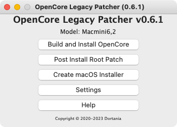

OCLP is much better than other patchers. See here for Mac Pro. I am running latest Monterey on my mini Late 2012 without any problems at all. OTA updates work well, too, although they are massive (full installer).

The app will recognise it automatically and offer the best settings possible.

IMHO I believe OCLP is easier to execute, and it is more stable*. Root patches just need to be reinstalled after a macOS update.
*That is because everything happens in the EFI partition and online (resources are pulled when needed), OCLP does not alter macOS per se.
